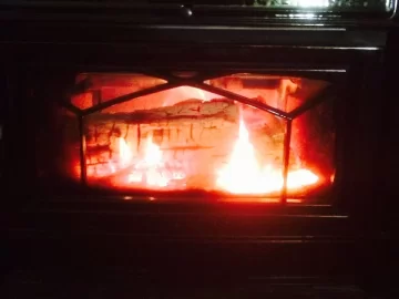

Had a new Hi400 installed back in late November. The burn times really haven't been good in it. I have adjusted the damper opening with the restriction plate down to a paper thin slit. Yet the wood becomes completely engulfed in flames when the damper is closed. Seems the damper is almost completely useless as air still enters from other source(s) completely unregulated.

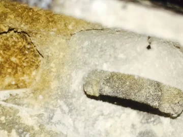

Here it is with the damper closed.
[Hearth.com] Hampton HI400 burn time
Damper opening:
As you can see it's pretty blocked off

Have you had the installer out to look at it? To test the draft? Also can you zoom out from that pic of the opening a little? It looks like the intake port without the restrictor plate in place but its hard to tell from that pic
The picture is of the restrictor plate, it's blocking 95% of the intake port. Hard to get with a camera, but I said in the OP "I have adjusted the damper opening with the restriction plate down to a paper thin slit."
Yes a saw that you said that but i was saying from the pic it does not look like that. Have you had the installer or dealer out to address the issues and look for problems/?
Not yet, just trying to address issue myself for now.
Who installed it? If it was installed by a pro they should come out and address your issues at no cost. If you installed it yourself you may need to pay for a visit but if it fixes the issue it would be worth it.
If the restricter plate is in correctly and adjusted down as small as it can be then you have to start restricting the air inlet outside the unit. But honestly that picture does not look like any of the units i have installed with the restricter plate in place. They may have changed the design i haven't done one in a couple months. How tall is your chimney? How much wood are you putting in the firebox? Honestly I would recommend calling your installer or dealer for help that is what they are there for.
chimney is 26'.

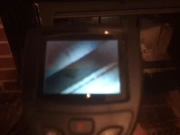

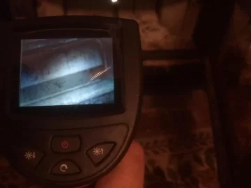

What you are seeing is the restrictor plate behind the dog house hole. I couldn't get the camera/mirror angle right to show the opening which is blocked by the top of the dog house.

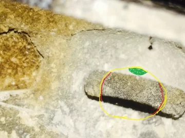

I tried paint...no laughing
Yellow is original opening...red is were restrictor plate and original opening overlap. Green is the hole in the restrictor plate and size it is reduced to at current time.
ok i am sorry it is zoomed in so close i wasn't seeing it properly but i do now.

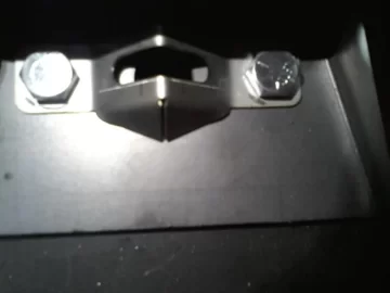

If your damper does not look like it's slowing the fire down it maybe your bypass does not close fully. When you push the rode in on the bypass it should go just about all the way in with the circle at the end less then an inch from the unit.
Reactions: Roy Batty
Hmmm. sticks put about 1 3/4" when closed. When closed should the flames near the back be pulled to the front of the unit?
Winner winner chicken dinner.
Thanks guys, now I know what the issue is and will call the installer
