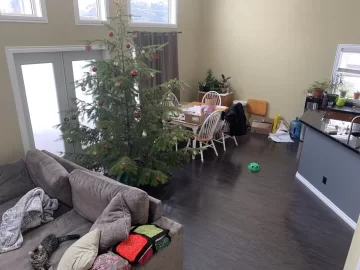

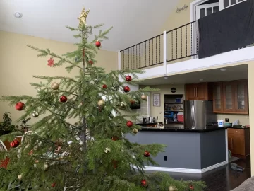

I’m going to put it In the corner kind of aimed towards the hall! Unfortunately directly across from my hall I have French doors onto the deck so it’ll have to go in the corner.

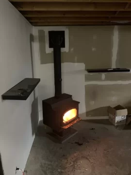

I’m honestly not sure what kind of insulation they have in them.. I’m assuming some? It has drywall up and taped but not finished. Concrete floors. The basement gets cooking like 28 degrees and in my living room upstairs right now it is 18. Wood stove has been going all day..
I’m attaching some photos for reference so you can see if you think my location is okay? Excuse the mess, I moved in 2 weeks ago and doing some unpacking today. First photo where you can see plants in the corner, plants are where the stove is planning to go facing corner out towards the inside of the room. Second photo shows kitchen and hallway where the heat should be aimed.

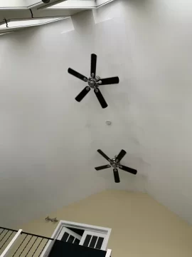

I’m also attaching a photo of the ceiling fans. Do you guys think they’re low enough?

One would assume that there is insulation behind the drywall in the basement, so that is good and should keep a lot of the heat from going to the earthworms. That concrete floor will still act like a great big heat exchanger, bringing in cold from the ground and putting warmth into it. So sometime in the future it would be good to get some kind of barrier there (which will be a PITA since you'll need a hearth pad, and that will mess with the exhaust pipe lengths.
I'm not sure about the ceiling fans. I would think that they would be fine as you just want to disrupt the air, but others that have that situation would be better able to answer that question.

For the insulation, I looked at the only place I could see in (around the window sills) and it looks like I have pretty thick styrofoam insulation between the drywall and the foundation. I pulled down insulation from between the two floors when I moved in as the heat exchange was even worse when it was up, so I’m assuming anywhere where there’s not the styrofoam should be insulated with the same stuff that was in the roof.
Thats a good point about the hearth pad/getting a barrier up on the floor. Especially if I’m just gonna be running baseboards down there unless it gets really cold.
This may help with ceiling fan question
