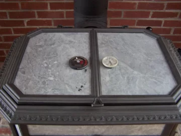

    Took the IR gun and shot my stove top,,, originally had my surface thermometers all the way to the rear,, this is were the IR gun showed the highest temps. Spots on stove top are water from snow melting off my hat,,, snowing again here.:)
