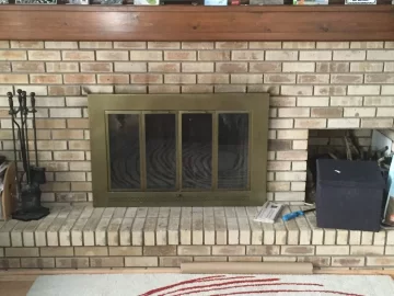

Hi all, first post on hearth.com. Many thanks for all the great insights, tips and information I've already discovered here. Who knew there was so much to learn about simply burning something?
Anyway, the reason I've put my virtual pen to the virtual paper is that it's been cold here (Denver, Colorado) and we have realized our gas bill will be huge and our fireplace is a huge part of that. Not only does it not heat even the family room, it sucks whatever heat there is right up the chimney - even when its not lit and the damper is closed. So, time for an insert to fix all 3 issues.
My wife wants one to match the HD TV - rectangular, black surround and a flat-screen with a big view of the action!
Some information to help :
Our house is an open-plan tri-level - 2,600 sq ft. The goal is to supplement the natural gas heating as much as possible but not to make fire-tending a full-time occupation!
The opening is 42Wx25H and firebox is 25" deep so there is room for something huge, in fact, neither of us wants a small unit with a large expanse of black surrounding it. I have attempted to attach a photo of the fireplace as it looks today.
The chimney is about 20 feet tall and draws well - it goes up through the inside of the west-facing wall and appears to be made of concrete blocks cemented together. I'm not a fan of this method of chimney construction in a wood-frame house - the risk of a small crack in the cement causing a fire is too great - so a full chimney liner will definitely be going in.
A lot of research here and on manufacturers' web sites has narrowed my initial list to just 3 units - 2 non-cat and one cat.
Regency CI2600 - the forerunner at the moment
Napoleon EPI3C
Osburn Matrix
We would've just gone ahead with the CI2600 but for the long thread here (https://www.hearth.com/talk/threads...-ci2600-fireplace-insert-risky-costly.132252/) about burn-time issues and what I perceive to be the extra care that needs to be taken with the catalyst unit. We can get one in 1-2 weeks for about $3K plus liner and installation.
Are there any other units we should be considering and what do you think about the Regency and its cat for a complete fireplace noob?
All the best from Denver!!

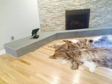

Here some pics
  • [Hearth.com] "HD" Insert - Recommendations Please!
Very cool Dmitry, I especially like the 'model'!

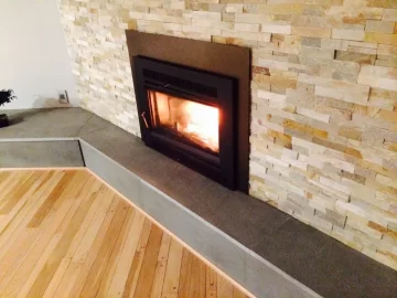

Too soon to tell how it will perform over the years but for now I'm happy with it. PS : thank you Grisu.Your input was really valuable .
You are very welcome. I am glad you like it. That's a nice looking install. However, one remark: Do you have 16" clearance from the door to the edge of your hearth? Maybe its just the picture but that seems short. Plus, I would be worried about the fur laying there. I had enough embers pop out that far which would have left some ugly marks.
Omg, Grisu , you ARE minister of fire.Yes , it's 12 inches . I was planning adress it after install . I think my main option is one of those removable hearth extension . Im gonna start new tread now . Don't want to steal this one

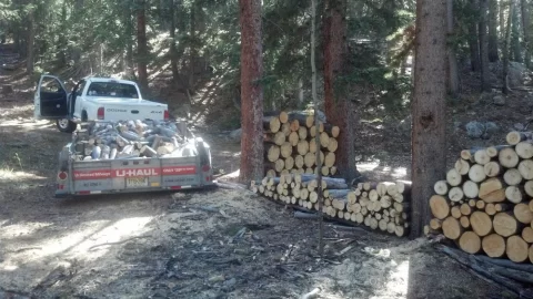

Fresh shoulder season load coming home before the snow hit.
