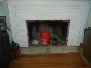

Im looking to redo my hearth since I recently acquired an I3100 insert. Ive been looking around online for ideas and I really like the bluestone slab look. My question is if i pick up a 1.5 inch thick piece of bluestone that is long enough and wide enough can I just lay that down in front of the fireplace opening and be done with it? do you think that would meet code?

Its going in front of the stove for spark and ember protection. I need to extend the hearth about 12 inches out from the end of the area i broke up to be over the 18 inches for code.

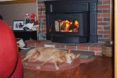

Here's the HI300 Insert from Hampton (Regancy). I used a 1.5" slab of brownstone layed directly over wood floor. Mine passed because I have the stove on a raised hearth. I think your hearth is flush to the wood floor so that may be an issue with laying a slab on top of the wood floor.
Yep, i dont think laying a slab will pass based on what ive been reading. Im just going to lay down some micore and build up from there to get over the required 1.1 R value that Regency calls for in their specs.
Nice Hampton you have there btw.
