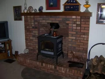

Grady223 said:
I have been looking at hearth mounted stoves (vent thru existing fireplace). Went to a local dealer (Central NH) who carries, and has recommended, the Jotul F400 and the Hearthstone Homestead. Are there other manufacturers that you might recommend? Looking in the 50,000 to 55,000 BTU range. Fireplace is 29" high.
I wouldn't install the Castine (F400) in that situation, ESPECIALLY iif you're not using it during the colder season.
The door opening is too high - above the baffle - & you WILL get smoke back into the house unless you vent off the top.
The Castine is a GREAT stove vented vertically, but iffy with a rear exit.
The Homestead is a nice stove as well, but it's a 24/7 November to March burner.
It may take too long to heat up for your tastes...
YMMV
