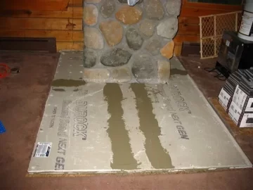

Today I removed all the dry fit tiles along with the cement board.. Cleaned up the floor and proceeded to mix and apply the thinset and screwed down all the cement board.. Gotta say my knees, back and legs are sore lol.. I could never do this for a living! The cement board will be inspected on Thursday and thinking I will add cement to tie the cement board to the chimney.. Added a pic to show progress..

Ray, I just had a fellow here looking at your pictures and he wants to hire you. You did say you would like to do this for a living didn't you? After all, your knees are in good shape....
Looks good Ray.
Looks good Ray.
LOL thanx Dennis! How did your inspection go? I will get the Durock base inspected tomorrow and I feel that will go OK.. I drew all the details for the inspector when I got the permit and nothing was said so it should be no problem as I followed the details to the letter.. My knees feel much better today thankfully! I couldn't do this for a living that's for sure!
Ray
Hey Ray, the inspection went as expected with no problems at all.
Ya, take it easy on those knees. They have to help you for many years to come and it is very painful to get them fixed.

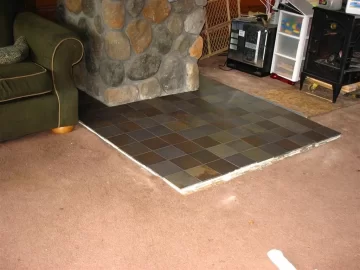

OK the Durock was inspected and approved so I proceeded to install the tile.. It's far from perfect with some high and low tiles but here is a pic with the tiles thinset into place..

I like the look . . . and as for it not being perfect . . . my father-in-law used to say that folks who found faults in other's construction were often looking for trouble right from the get go . . . I think it looks fine.

Thanx Jake! There is no worse critic of my work than myself! I think that once the grout is done it will look pretty good.. I have learned alot about tile setting and my next project should come out better! As for fire safety I feel I have done well with the specs the stove called for (I tried to exceed the minimums) and have gone a bit beyond in hearth size and ember protection requirements.. The one thing that will come out of this is I did it myself along with loads of research and input from the great people at this forum.. Still thinking how I will trim/protect the edges of the tile..

Thanx Oslo yes I am looking forward to getting this completed! Hopefully the new stove will meet my expectations as well.. The overall height of the hearth is around 1.5" so I need to consider how I can trim this hearth to protect the tiles from the vacuum etc..
Ray
maybe some kind of bullnose tile, cut to fit the sides?
I thought about that but the sides are just the raw edges of 2 layers of 1/2" Durock plus the tile is thinset down and very near the edge of the Durock... Thinking I might try ripping a premium 2"x4" down and staining it to match then poly it.. I would screw and glue it to the subfloor and use brown caulking to seal it to the tile.. I will rip a scrap piece to see how it looks..

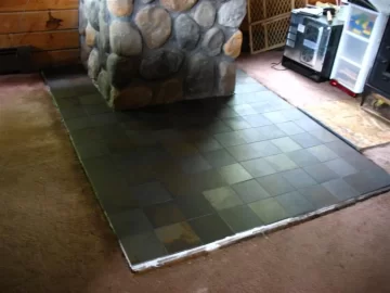

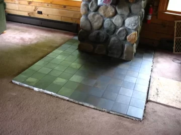

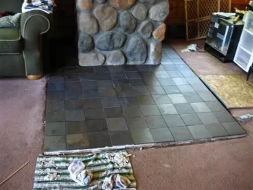

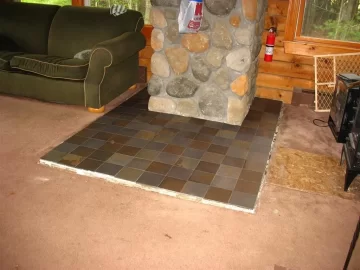

Today I grouted and cleaned the porcelain tiles and it looks pretty good so far.. I have attached some pics to show the progress.. This leaves masking the tiles surrounding the chimney so I can I can add cement to tie the hearth into the chimney then add a border around the hearth which I haven't figured what to do...
Ray
  • [Hearth.com] Hearth project started (With pictures)
Ray, It looks really good and I really like the tile color! If I was you I think I would just rip down some wood stain it to match your walls, use power grab on the back of the trim where it meets the hearth, toenail it to the subfloor along the bottom of the trim piece, and then use some dark silicone to finish the top edge of the trim where it meets the hearth.
I like how you have the fire extinguisher mounted right there where it's handy to get should it be needed. Every year I say I'm going to get one but keep forgetting to pick one up.
How hot did that couch get when the dutchwest was fired up? We have a chair that was 28" to the right side of our old Dutchwest and it got hot enough to make me worry a few times.
