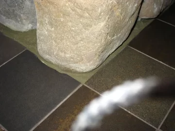

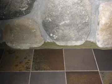

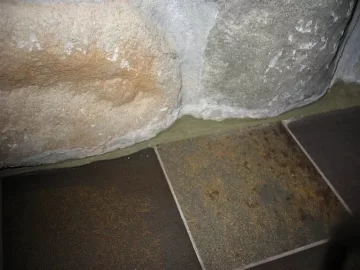

PS: I know you all want pics lol so here they are..
  • [Hearth.com] Hearth project started (With pictures)

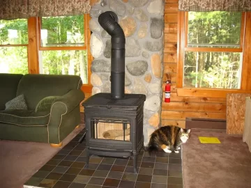

Hi Chris glad to hear from you and the stove is now on the hearth with only red oak trim work to be done (yes oak isn't just for burning).. Glad your family is doing well and good to hear from you! OK now for the pic of the new stove sitting on the new hearth sans oak trim..
Ray
So nice! Are you trying to make it a cat stove? LOL
(That's a big cat. Is it a Maine Coon Cat?)
LOL yeah that is my new "cat" stove... The cats like laying on the hearth as they find it cooler due to the 100+ degree temps here right now.. My cats all 3 of them are from the cat pound.. Such a shame to let such beautiful critters be destroyed and they are pretty good pets despite the abuse they suffered..
Ray
Ray, It looks great!! You should be thrilled with how well it all came out. Have you installed the blower yet? I put mine on the other day and I am suprised at how quiet it is compared to the blower on my Dutchwest.
Ray
Ray I've got to say that looks like the perfect setting for a freestanding stove. It looks beautifull with the stone finish and the wood in the background. That new tyle really makes it stand out, excellent job! Looks like the feline approves it too!

Thanx Chris I look forward to the red oak trim that will surround the hearth as I feel it will tie it into the log walls and protect the tile edges! Yeah the cat doesn't add much heat in fact she tends to only take it away!! Cats do make good paperweights though :)
