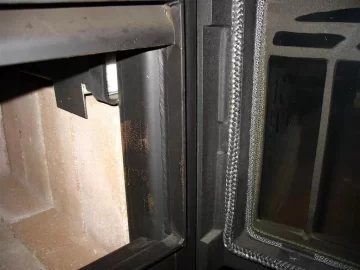

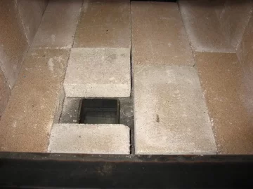

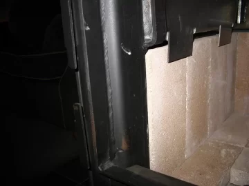

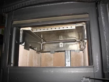

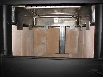

Just thought I'd take some stove interior pics before it is ever burned in for future reference.. The welds look solid to me and the firebox roomy with no obstructions.. North-South loading will prevent log roll out plus the firebox is pretty deep to keep ashes inside.. The ash dump seems pretty cool and should be OK..
Ray

Look at all that purdy stainless, you sure you want to ruin it by burning it? ;-)
LOL Todd maybe I'll wax it 1st.. Still mid 70's here so a bit warm to burn in but am thinking about a couple small fires to bake the paint.. Good time to do it as I am alone right now..
