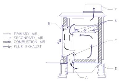

I am wondering if anybody here knows anything about the Clydesdale with respect to exactly where it gets it's intake air from. I'm not looking for I thinks and maybe's. The reason is I want more control over the low burn Right now it's way too easy to go hot and th eonly way to shut it down is to open the door. I have a 6" insulated 15 foot liner. Draft is excellent and I have really dry wood. Suggestions on controlling are fine but I really want to know how this stove is designed... where exactly does it get it's air from even when the damper is shut completely?
Thanks all.
Email Hearthstone. I wanted to know the same thing about the Mansfield and they promptly sent me this...

Thanks... will do.

I talked to Hearthstone. They didn't help a whole lot but did say there are entry points for the secondary air.
