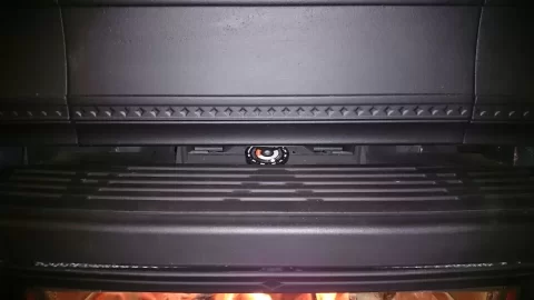

Can you post a picture of the unit showing where the Rutland Stove Thermometer is located? Is your insert flush or did the installers install the unit out on the hearth?

Here is a pic of the stove. You can see the thermostat on the top. I took off the grill for now until I can get a sense for how the temps are running. You can see I'm just starting the fire now. The top of insert sits about 6in into the room. I wanted it as far into the room as possible to get as much of the radiant heat as possible from the stove into the room.
The fan just kicked on with the thermostat reading about 275.

Where do you measure your temperature on the stove? I mentioned earlier I measure on the back side of the stove as my magnetic gauge is too large to fit underneath the grate on the front top, but from what I'm reading I may be a little over cautions being concerned with the temperature at this part of the stove. I may run without the grate from now on and just check the temperatures right next to the damper bolt. I purchased an IR temp. gauge but find it difficult to get a good measurement under the grate with it on.
