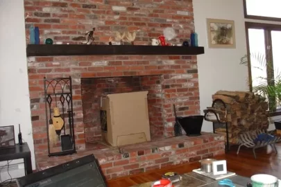

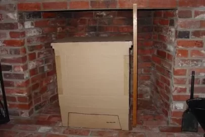

Since I am a complete toolbox w/ OCD I made some mock cardboard to scale of the Craftsbury. You can see that I have plenty of mantel clearance. I need 16" according to the Craftsbury manual and I have over 18". That cardboard stove is sitting exactly 16" from the front edge of my hearth. You can see that there are no side clearance issues and I have plenty of depth. I also have plenty of room to connect the flue pipe and access for cleaning with a straight shot up the flue.
Although this stove doesn't completely fill the firepalce, this will actually be good as it will allow the heat to circulate freely around the stove. Hearthstone also offers a blower kit.
