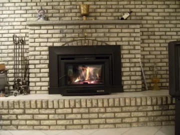

tickbitty, I had the same issue as you.. 32 inch high opening... I preferred the cast standard surround versus the boring over sized one so I ordered up a set of the surround end caps and raised the surround to just cover my arched opening. Personally I think the surround caps should come with the insert but that's another story.. The whole rig looks much better with them..
Here's a few pics..
  • [Hearth.com] Hearthstone "Issues"

Bren, I see what you mean - good job, that looks really nice! Thanks for the answer!
