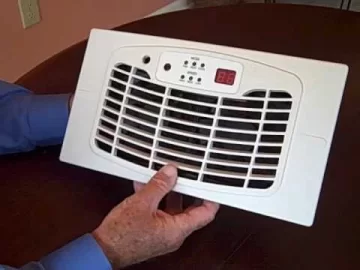

    Has anyone tried one of these to help distribute heat from room to room or level to level? I think it may work with the layout in my house, just curious if anyone has experience with these in-wall type fans. There's a few different types out there, Comfort Geni, Airflow Breeze, etc.

    Consider the electrical connection as well. Some fans have regular plugs, some are designed for hardwire. Do you have an outlet close enough to the placement of the fan? Which side of the fan does the cord come from? And is that the proper side for YOUR install. Just something to think about.

    ^ mine had to be hardwired, had an oulet high on the wall from a bar light, perfect.

    The ones I looked at can have the power cord attached on the front or back, depending on your situation.

    Have the same one. Works wonders.
    But the one I can't live without is like this. I suspended it from some hooks and with my thru the wall fan on the opposite wall really speeds up the heat. I can tell without looking if the fans are on.
