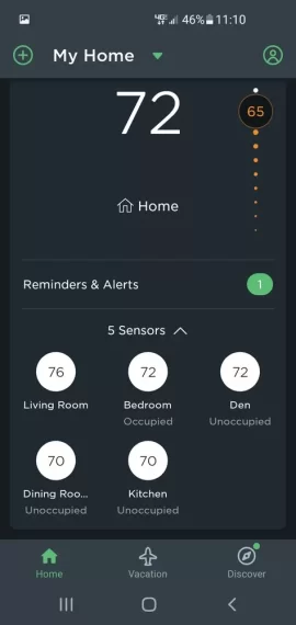

I have an ecobee smart thermostat and a temp sensor in every room which I find incredibly helpful for wood burning...especially since the main thermostat is located in the stove room. I can program which rooms I want to use for temp averaging which will determine when the backup heat comes on. I usually pick the 3 coldest rooms in the house (kitchen, den, dining room) and go based off those 3 that way it's never colder than 63 anywhere in the house. Then in the summer I do the opposite and pick the warmest rooms when I run the AC.

Here's what my thermostat app looks like, I can control everything HVAC with my phone which is convenient. They aren't that expensive and make heating with wood + back up a lot easier.
