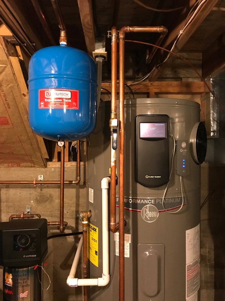

I have the Rheem and it is whisper quiet. I can barely hear it running and have to stand right next to it.
I love it! Can’t recommend it enough.
