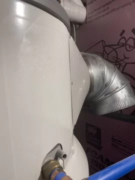

Well following up on this two years later…. Maybe only one since I installed the ducting. The room is no longer a bedroom it’s a library with an open door way connected to the rest of the basement. Mechanical room is now closed off by louvered bifold doors.
The reason is it it completely vented indoors. With the ducting kit and 2 adjustable elbows an some flex duct, the intake draws air from above the the bifold doors from the library through an extra filter (and a bit from the suspended ceiling space). The exhaust elbow points down to the floor. This arrangement keeps the air very stratified. Hot moist air up too cold dry air down low.
The HPWH can cook the basement significantly when we use lots of hot water. Last winter it was not uncommon to have basement temps in the high 59s low 60s. We didn’t spend much time down there and I was still trying to heat 100 % with wood from upstairs. This winter has been warm and we are using the heat pump more and now we have the wood insert installed.
I am a bit concerned about condensation on the outside rear of the unit. It’s enough at times to run down the side but I never see a puddle at the bottom. This usually happens during the summer but it was warm and humid enough for it to occur yesterday. I don’t see any way to avoid it. Eventually if it runs enough it dries out.
Thinking of the absolute best way to vent would be to exhaust to the the air return we only have one). But running cold 40-50 degree air through the crawl space is asking for moisture issues I think. Any colder climate than ours it’s going to increase heating load if venting/ installed in a finished space.
It’s been a great investment and has cut the amount of time we run a Dehumidifier in half.

I'm confused. I thought the HWHP would cool the space as it pulls warmth from the air to heat the water.
It does. And if you are heating 80 gallons it takes a lot of heat out of the living space. So during the winter it can make it quite a bit colder down there.
Maybe when you said cook the basement, you meant cool?
Must mean cool. Looks like the install worked out well overall. We also appreciate the dehumidifying we get from our HWHP In the basement. I’m far from a pro but I managed to install ours. I’m guessing your HP must have has condensate drain and the backside condensate is separate from that?
Yet you are correct I meant cool. And yes separate from the drain.

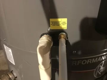

[Hearth.com] Heat pump water heater ducting question?
It looks like the plastic nipple is the condensate drain and if it is it should have a drain tube. I was lucky to have a cellar gravity drain to run the clear plastic line pictured to.
My understanding is both are draining the condensation. The small one is there if the the big one gets plugged the water has somewhere intentional to go.
Reactions: sloeffle
Clearly then that’s not the cause of the moisture. I wonder that there is a cold area where the moisture condenses on the metal jacket and if a thin layer of foam insulation, like what’s used in a toilet tank, over that would prevent the condensation. It does sound like it’s evaporating. I thought about ducting the air intake on ours from outside and leaving the exhaust as is in the summer for some gain but that didn’t seem worth the initial effort and the twice a year changing over. I guess that would add additional moisture for the system to drain off as well. My unheated cellar drops as low as 45 or 50 at the coldest times. I pretty much keep it electric mode at 50 or below.
