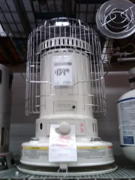

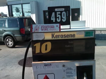

Why Not Kerosene?? :)
$139.00 for the unit at Home Depot and only $4.59 per gallon at the pumps!!
Don2222 said:
Hello
......... only $4.59 per gallon at the pumps!!
Thats why! At $4.59, its cheaper to use HHO, Electric, or even LP. Thats way ti expensive. IMO
