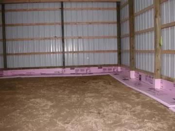

Here is how I insulated mine. I don't think I would want insulation under the main slab. Too soft.
The biggest mistake I made was not running floor heat lines in before pouring the concrete. It's not that expensive to do. Then you can get a wood or wood/coal boiler and heat the floor. There is no better heat than the heat emanating from the floor.
Even if you never hook it up, it's there.
Currently I do not heat the pb. It's not insulated and there is no heater in it.
Too late for me to do it that way but I like it. I wish I would have know about that when they poured the floor, I bet it will keep the slab much warmer on the edges.
Back in my dump truck driving days here in Michigan, our shop had a heated slab over foam board. Drove 150,000+ lb trucks over it all the time.
