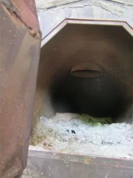

    If I understand the pictures, I think the reason that this stove is not working well as the other stove is that the flue is coming out mid-back instead of out of the top.

    The pictue of the inside of the stove failed to rotate when I sent it. So it looks like it's coming out the side.
    The stack comes out the top of the stove about 6" from the back.

    That's what I thought I was looking at, as well...but then I can't resolve that notion in my head with the pic with all the rocks and the non-ferrous pipe coming straight up, turning 90° and heading out. I'm still not sure just what this stove looks like. Rick

    OK, so it looks like this from the outside through the loading door...?

    Yes that's right.
