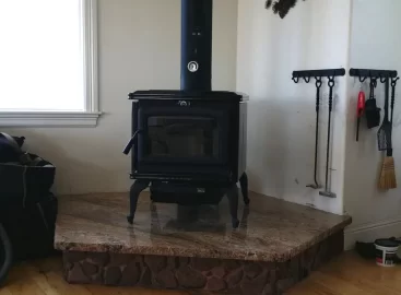

I built the fireplace at left, that hearth also is 3 inches high that is just right to me.

My hearth build; 2x6 treated lumber covered on the top with 4 layers of Duroc Next Gen and then 3/8" slate.
