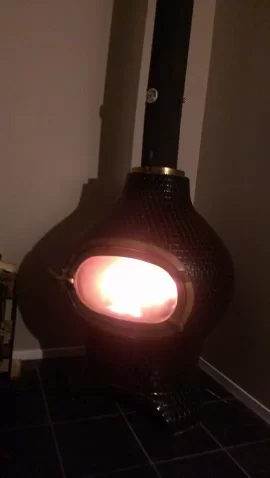

You know, you could be right, maybe it wasn't grey it might have been white. Like ordinary rope. I just remember seeing it and it looked right, but I havent seen this stuff in 30 years and back then they probably still used asbestos! These are the kind of people that took all kinds of things from the house that they shouldnt have when they moved out (except about 5 pieces of firewood, when it should have been a face cord), but doing this is beyond stupid, it is dangerous. Here is a photo. Not the best, one from my wife's camera, but I will post more once I fix the door. It is in pristine shape, although now I am starting to wonder if they used proper cement to patch the inside of the firebox. Well, if it pops off I can redo it. It isnt worth getting an ulcer over and legal channels will cost far more than the fix.

Cool looking stove! How old is it?..... Looks submarine-ish.
They were made in the 80's I think. The house is from '87 or so. I'm still trying to figure out if the basic design concept makes sense. The way the combustion air comes in through two jets, you get lots of swirl to help with the time-temperature-turbulence triangle that you need for good complete combustion. There is an inner spheroidal firebox lined with refractory cement, then an air space, then an outer casing also lined with refrectory, and the whole thing is covered in 1" sq ceramic tiles, like mosaic tiles. So it takes a while to heat up all that cement, but then you have a big heat sink for later. The room air is drawn in through ports in the bottom, heat up as it passes through the annulus between the inner and outer bodies, and comes out hot through a gap between the flue pipe and the top. The outside gets warm, but you can hold your hand on it without burning. Huge radiant heat from the big front window. The emergency wood supply that I got to see me through to the end of the heating season is quite wet and this stove has no problem burning it. If you search, someone here has posted the original manual and info somewhere.

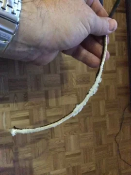

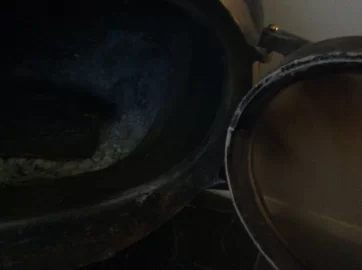

Possible. I have a hard time believing that someone foolish enough to think you could just glue in sash cord would make it to the store and back on their own. Here are a couple of photos. It was maybe 1/4" diameter, and on the woodstove side there is a flat surface, in the door a curved groove. It is going to be tough now to figure out the right size with no original to go by.
[Hearth.com] Hello, new member with a question[Hearth.com] Hello, new member with a question
Sure looks like nylon rope...
Spools mixed up at the hardware store? I could see that.

I can't imagine what they used, nylon rope? It's a shame to trash the Meridian like that. You may need a propane torch to soften the material if it goes hard when cool. When it's all polished up, post a picture of that unusual heater.
Another option might be one of the heat guns they use for stripping paint ... sounds like nylon rope:mad:
Any chance you can pop the pins on the door and carry it with you to the hardware/stove shop?

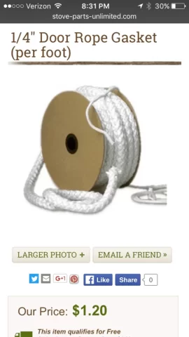

The door seems to lift off easily. The groove is 1/4" wide and looks half round so I figure I will try 1/4" material. Mostly what happened was the part glued to the door charred first. Makes me think leakage of air cooled the sealing surface. I think a lot of the melting my wife saw might have been glue. Because it all charred, I think I can chip it out. Thanks for the responses.
Wondering if a dremel might be of assistance in cleaning the channel...

If the material is melting at high heat, just start a fire let it get hot and use a scrapper the size if the seal channel to scrape it out. should be rather simple.
