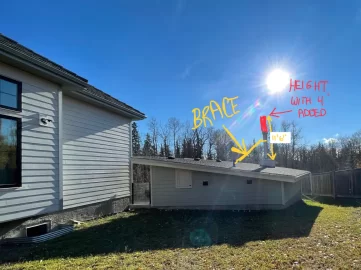

BIG NEWS! Our installer is coming out this Thursday to extend the chimney—and I’ll only have one kick at the cat. I’d appreciate any opinions I can get!
See the photo attached—First, our installer says he’s not sure how he will get up that high to add an extension (without a lift!), so he said he can only add one extension. He’ll have no way to get up that high to add a second one. This eliminates the plan you folks suggested about adding a section at a time until the draft improves.
  • So, do we just add 4’ and cross our fingers? Is that enough?
  • With 4’ added, the chimney section above the chase will be 11’6ā€ high (see photo). It will obviously need a brace. Does it need to be made by the manufacturer, or would any brace work? Will a brace be enough support for this height of a chimney?
  • Because of the chimney fire, I’m wondering if I should have him replace the cap, even though I don’t know if it’s damaged or not?
  • He also said the only cap that will work is the one from the manufacturer.
Again, regarding the extension, I need to figure out a solid game plan, so we’re not back to square one.

  • [Hearth.com] Help!😩Smoke Billows in Room! NEW Majestic Biltmore 42ā€
You'll need 2 braces (one each 5 feet).
What he said about the cap ("will work") is bogus. Many other caps may work. However, to be compliant, you need one of those that are listed in your manual, as noted above.
If the cap has no mechanical deterioration, a chimney fire is no reason to replace it. It's not that it protects your home from a fire (as the chimney wall and insulation does - and those are hard to inspect, unlike a cap).
If all you can do is 4 ft extra, that's what I'd do.
