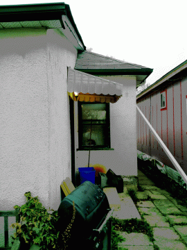

Also I wanted to ask, what is better? Flue straight up and out the roof or through the wall and up? I read something about keeping as much of the pipe in the house to keep the heat, as opposed to out the side and up. Something about the longer section of the chimney being outside in the cold and not working as well? And also the cost of the longer chimney. It just seems easier through the wall than all that work through the attic.
Because my other plan was to put the stove by the west window, remove the window, board it up and run the pipe though there. But then the stove would be on one side of the house and not heat all areas evenly.. The reason I wanted it at the end of the living room and through the window is that I only have 3 feet between the house and the neighbour's house where people walk so the chimney would be in the way if i ran it out the side in the middle of the living room.

Straight up will draft better, is easier to clean and it usually costs less. It looks like this is going to be a shorter chimney in a very cold climate so I would definitely give the flue every advantage you can.
