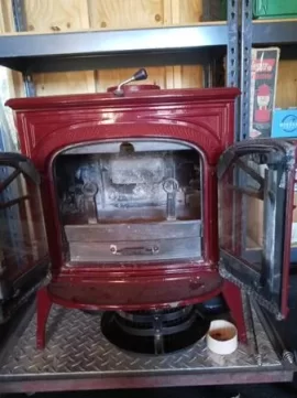

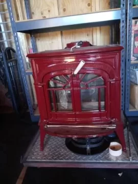

A VC Intrepid is for sale, not sure which model so any help would be appreciated. (I asked the owner but he was not sure.) We will be new wood stove owners. We live in Arizona at about 3000 feet so very mild weather. It is mostly for ambiance but the extra heat will be nice. I am aware of the cost of installing it. They are asking 1200. I am considering other small stoves but because this is available, beautiful and top loading I am interested. By the way, used stoves are harder to come by in Arizona.

That's the Intrepid II and looks to be a nice later one with not much use. Would go over it though to make sure no cracks in the cast or ceramics on the inside. Would feel good at around $1,000.

Thank you Kevin. I can get the Drolet 1500 for about the same price but since this is a better size for our needs (and top load and nicer to look at) I am hoping it is a better stove for us. But any input is welcome.
We have a ranch and think we will put it in the family room by the open doorway to the rest of the house. Most days in winter the furnace comes on first thing in the morning to take the chill off and then later in the evening. We are retired now and home so I might start a little fire in the morning and then burn a little in the evening. The house is warmed during the day by the sun. We plan to burn seasoned trimmings from our trees, like mesquite and palo verde--some logs, some bigger branches. Will this stove do okay if we don't burn cord wood?

I think your wood will be alright properly seasoned. The VC's are draft needy stoves. So if you're chimney set up has a so so draft you may want to consider a non-downdraft designed stove. Although the Intrepid II I think is a non-downdraft stove. By downdraft I mean the draft picks up the smoke and gases from the bottom back of the stove instead of conventionally at the top. Good luck with whatever you decide.

Thank you again. We are putting in a chimney from scratch. It will be set from the top of the stove, straight up through the roof and at least 16 feet, the minimum height. No elbows. So I hope that will give it sufficient draft. And if it matters, the house is not particularly air tight so the stove should have sufficient outside air.

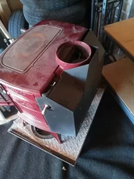

The picture of the stove shows a black metal thing on the back. I am guessing that it is a heat shield and so I can use the "shielded" dimensions for installation. We plan on using the double stove pipe as well.
I think we will buy it unless we see damage. Then I can come back with install questions. :)

Hi again. Yes, we think we followed the clearances. Our Intrepid came with the heat shield and then we added a shield, cement board, to the wall. We have double wall stove pipe straight up to the triple wall chimney pipe. We are in a one-story ranch and we put the stove in the addition so there was not really a "design". For now our cement board is just leaning on the wall. We painted it to match the wall. My husband put feet on it so it would be up off the floor and stops on the back so it would stay away from the wall. Not elegant but it works and maybe some day we will make something attractive.
I found the clearances hard to read in the manual. I kept going between the chart and the images they have, trying to get it all to match. If I remember correctly, they don't show the heat shield with a wall shield in the chart. But it is in the images. I followed the clearance in the image. The cement board has never been hot to the touch, just nicely warm. And the wall behind the cement board is cool to the touch. The wall above the wall shield, behind the stove pipe, gets warmer--but still comfortable to touch. I can imagine the clearances are generous, lawsuits and all, but we decided to follow them. (Also, I assume that the clearances are set for a roaring fire, full firebox, and we haven't done that.) Our couch is the appropriate distance away but the metal bucket of wood is pretty close to the side, 16"?. It never feels hot.
