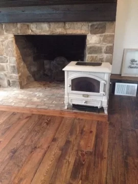

Hello all,
First post here, finally getting into the stove game. Astronomical heating bills hopefully will be on the decline.

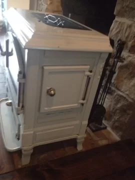

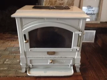

I purchased this stove refurbished by a local who buys and sells for a living in Easton, PA. I think it's an Efel Harmony. Not sure of the year, would love to know if it's UL certified. Has side and top loading. It is multi fuel, wood/coal. Also the exhaust is from the rear.
My plan is to have the stove 18 inches back from my wood floor, 1-2 ft of pipe connecting to a T, then another 3 ft up connected to a steel plate and SS liner. Chimney is about 30ft high.
Anyone know the year/model or any feedback on my plan/the stove itself.
Thanks! [Hearth.com] Help ID Efel and stove setup[Hearth.com] Help ID Efel and stove setup[Hearth.com] Help ID Efel and stove setupm mm [Hearth.com] Help ID Efel and stove setup
I would guess a Harmony I Mix, but it might be a Harmony III . How wide is it? New models are top exit only I think.
There should be a UL tag on the rear identifying the model. You'll want a manual for mantel clearances.
http://www.efel-usa.com/Harmony-I.aspx
