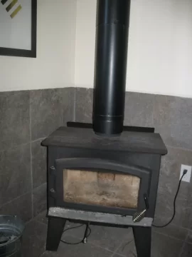

    ok, now a picture of the stove...

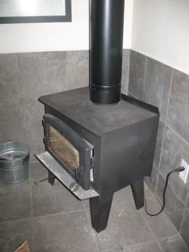

    Instead of a mirror, if you have a camera phone hold it behind the stove and take a pic of the model plate. Welcome to the forum.

    The stove shouldnt be hot to the touch it should be untouchable without getting a serious burn.

    Please tell me either:
    A: the picture is an optical illusion and your stove is not as close to the wall as it appears in the pic...or
    B: There is cement behind the tile.
    Edit: hmmmm, doubt that there is cement behind it. There is a plug in right there.:(

    It's about 5" from ceramic tile at closest points, as you see, set in a corner, so corners alone are 5"; There is hardibacker, the thicker variety...i forget 5/8 or 3/4" thick...all around in back of the ceramic tile.

    I think that is the 2000 model and if so, requires 11" of clearance to combustibles from the corner of the stove. The pic is not convincing me that it is.

    Concerned as others about how close the stove is to the wall. Dig out some sweaters for awhile, add pair of warm socks and add another blanket to the bed. I would not try to get the temps up on this stove until you know everything next to and behind it is non combustible. The tile protecting sheetrock is not a non-combustible situation. Looks like you only have 3 inches on that right corner.

    P.S. professional chimney installer did not think it was too close to walls...

    Maybe its farther from the walls than the picture shows, pics can be decieving.

    ok, let's say that it should have been placed further from walls, despite the thick hardibacker, my question is would this being too close to walls be WHY the house is not getting warm? Maybe combined w/ air control not being closed after getting fire started as stated above?

    If that is a 12 inch cermic tile, that can't be a 5 inch clearance. It might be 5 inches into where the 2 walls meet, but the corners of the stove are set kitty corner. you have a floor tile that is about a 1/3rd of a full tile and the leg is sitting on the grout line at the corner of the stove

    Hardibacker is cement, to best of my knowledge...

    5" to the ceramic tile means that you would have to have 6" of other non-combustible material in front of the wood studs. I doubt seriously that that is the case. A pro doesn't think - s/he knows.
