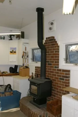

This is not the right kind of pipe, but it illustrated what we are talking about.

No, that's not the problem with the lack of heating. But, as has been said, this clearance issue needs to be addressed before the other issue(s). The problem with the way the hardiboard and tile are installed here is that they are applied directly to the combustible wall, and therefore do absolutely nothing to make reduced clearances safe. The clearance to combustibles in this case is the distance from the closest point of the stove directly to the surface of the drywall behind that hardibacker (just as if the tile & backer weren't there at all). I'll attach a pic of my shop stove to illustrate how 2 45° elbows are used to create an offset. In my case, I was actually moving the stove back, where in your case you need to bring it out, but you get the idea. If the 2 elbows married directly together do not provide enough offset, then a section of pipe is simply installed between them to achieve the necessary clearance. Rick

Thanks for posting that, Rick. A pic is worth a 1000 words.
