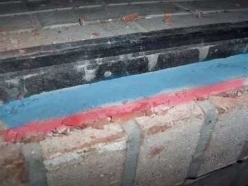

It is not drywall. It looks like acoustical board, I wonder if this is micor? There is drywall on the facing but not the opening. It will smolder if I put it over an open flame, but it does not light on fire. Would pulte , one of the largest home builders in the country really use combustible board here? I doubt it. I should have left it alone.

Ok, making sure I understand correctly. In my picture, the blue is some sort of apparent non-combustible board, and the red is drywall? If this is the case, still does not seem right to me. For our fireplaces anything above the bottom of the fireplace (not the opening but the actual metal shell) within 20-30" (depending on model) cannot be combustible.

I, for one, would sleep better after knocking the thing out and rebuilding to a spec I felt safe with.

As I said before, I would find a manual for your ZC box and study it. Its possible that may be allowed, but I doubt it. Check hearth clearances, and also sidewall clearances. The brick face and the micore plays no factor where the drywall lies when looking at the manual specs unless they specifically list reduced clearances when those materials are used in that fashion.
