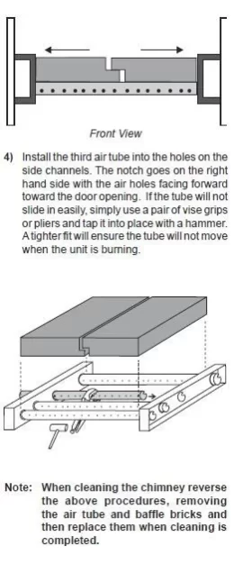

Anyone know how to remove the burn tubes on the Hamton hi300? I'm trying to clean it and can't figure it out.
This is from the Regency manual for baffle and tube installation. Cleaning is the reverse. It should be the same procedure on the Hampton.
[Hearth.com] Help please removing burn tubes
i've always stuck a red robertson screwdriver into one of the hole near the middle and hit the side of the screwdriver with a hammer to move then in and out.
Thanks guys I was worried about crushing it with the vise grips.
Good to be concerned, go gently with them and use the style with the curved jaws made for pipe or use skinanbone's method.
