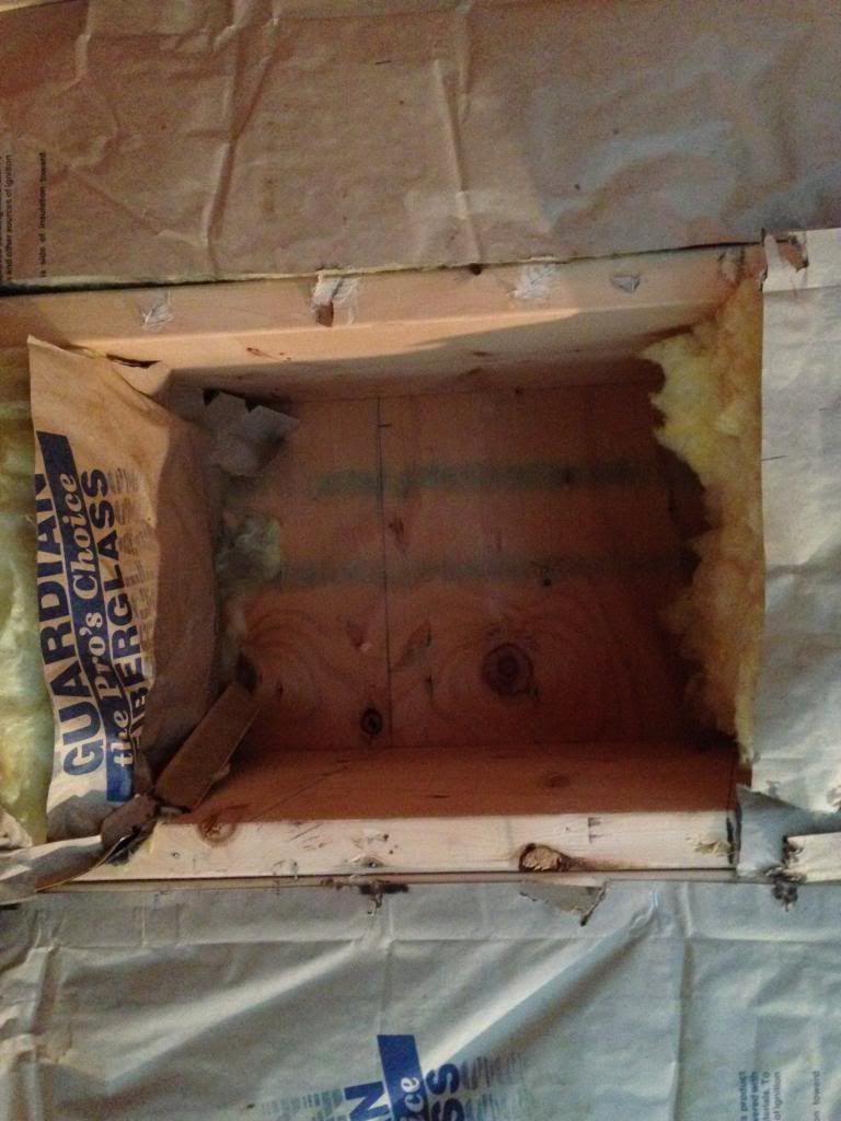

    Step 1: Clear the insulation where the chimney is going to go.

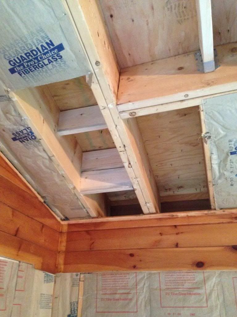

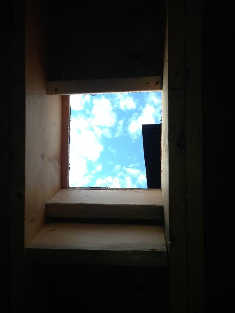

    Step 2: Installing some blocking to make a 12"x12" frame for the Ceiling Support Box. My rafters are 2x12s so I used a few 2x6s to block from ceiling to roof.

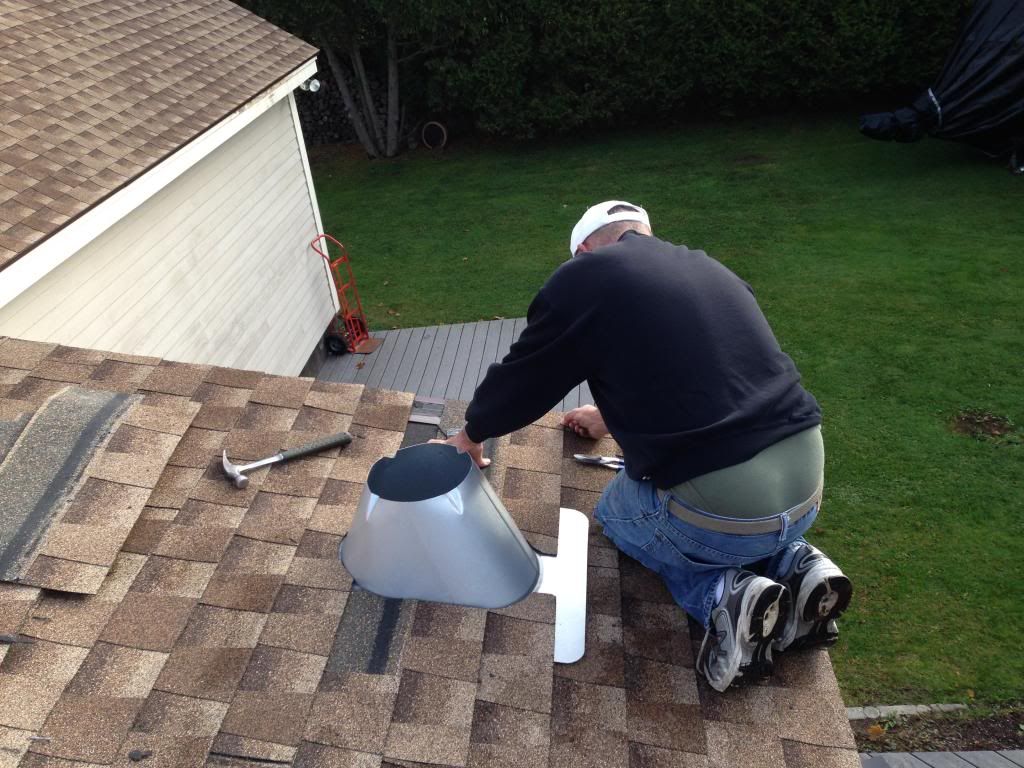

    Meanwhile, up on the roof, my buddy Kyle is stripping shingles that we just installed about a month ago...cursing me as he goes...

    Step 3: COMMITMENT...cutting a hole in my brand new roof...this just feels so wrong...

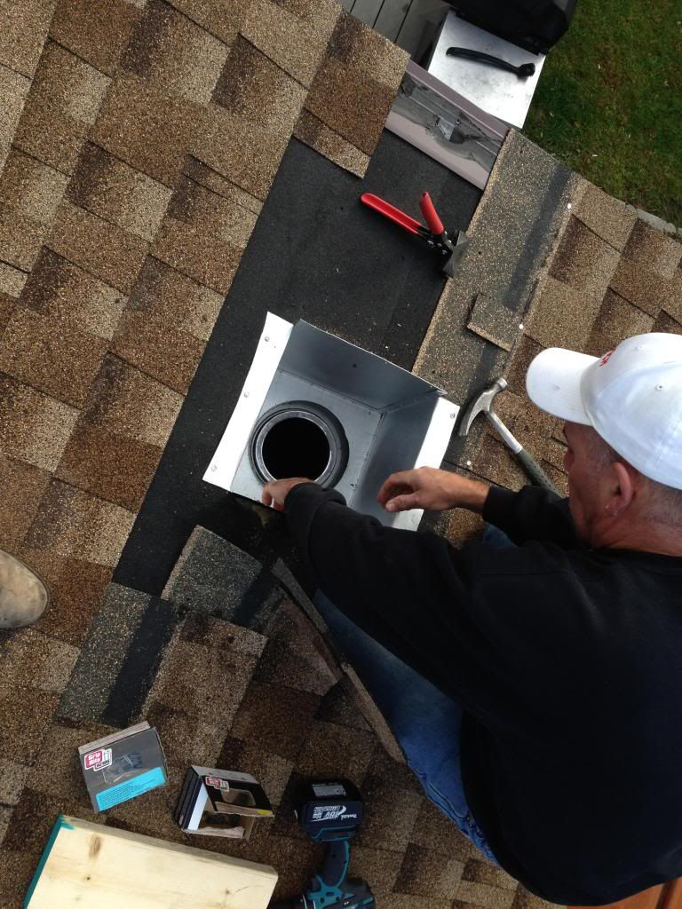

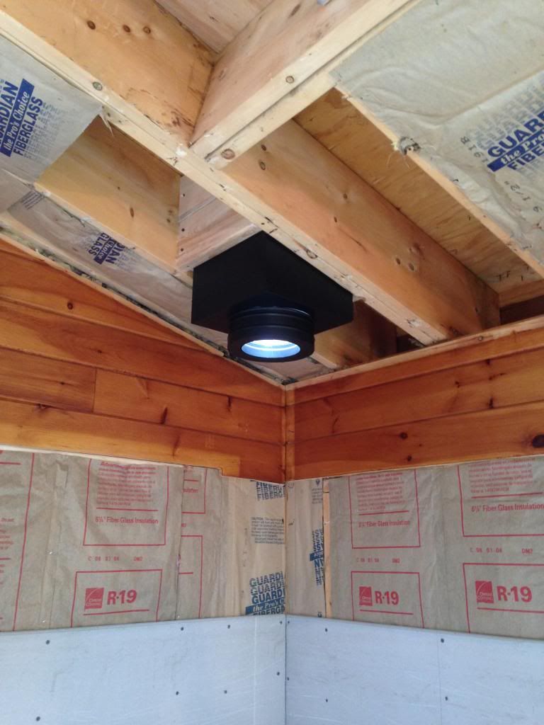

    STEP 4: PENETRATION...err...umm...well...you know...stick the big black thing in the hole...ummm...no...I mean...well....the ceiling support thingy...time to see if it actually fits...
    I marked the support box at the 3" from the bottom so I'd know just how far to slide it up...3" at the rafter should be just over 2" once I put the ceiling back up...pre-drilled a couple holes in the side of the box for mounting (that's Kyle's job up top)...got the 2' level and put it right where I want it...then I yelled up for him to drive in a few screws.
    THis seems about right...

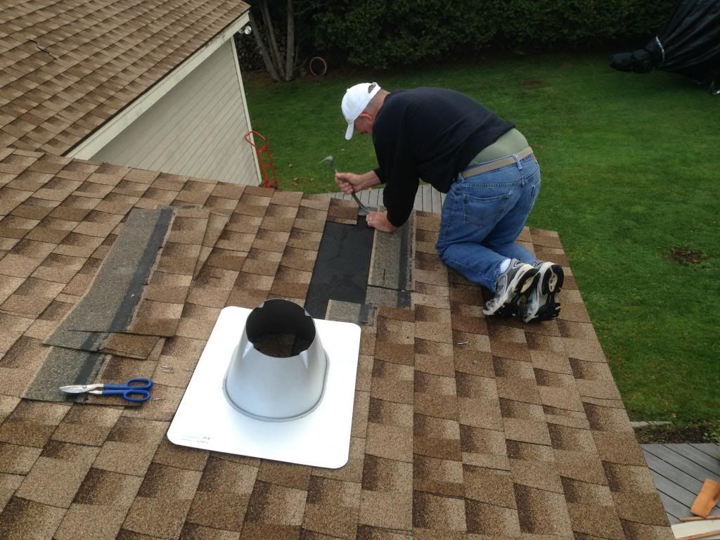

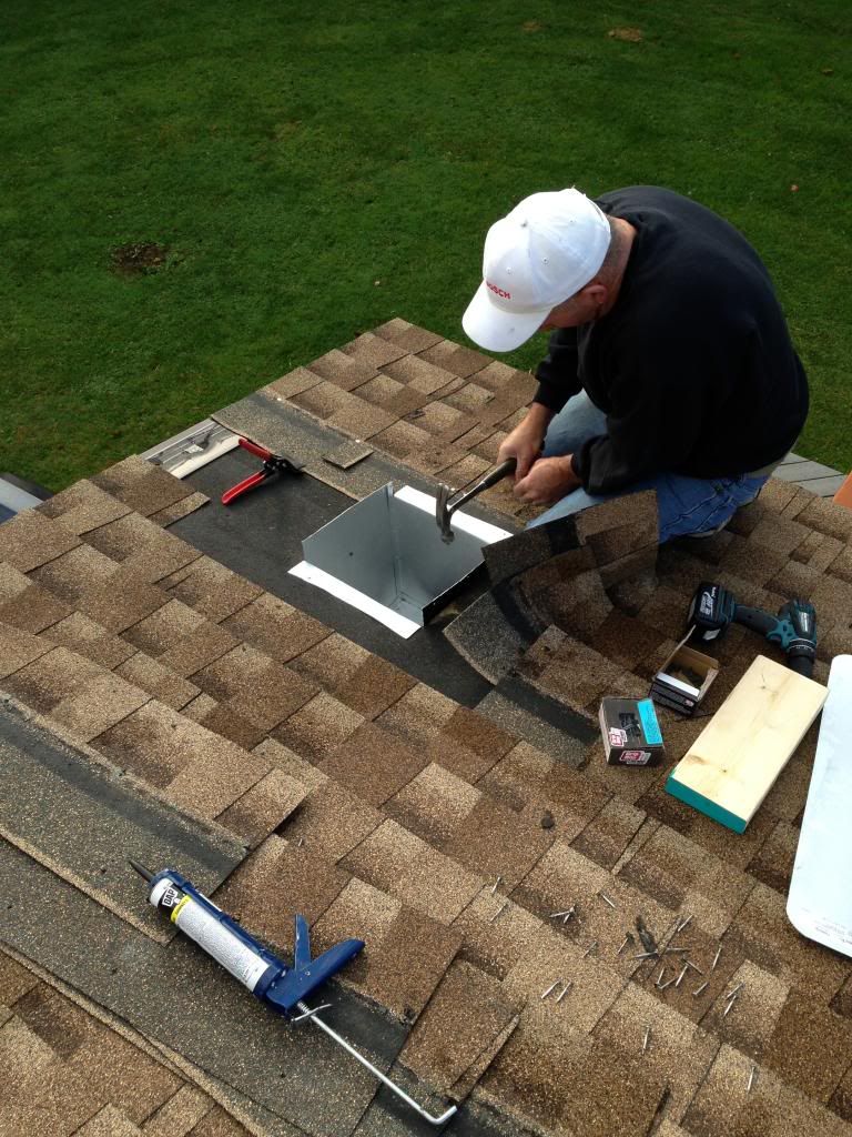

    We discussed how to handle the portion of the box that extends above the roof. I considered just cutting it off flushwith the roof sheathing, but instead, we trimmed it off about 1.5" above the roof, cut the corners with snips, and then folded over the sides to create a flange of sorts. With screws already going through the walls of the box and into the blocking/rafters, this was complete overkill, but it felt right at the time. I'm pretty sure that I can swing from the support box now and it will never move.

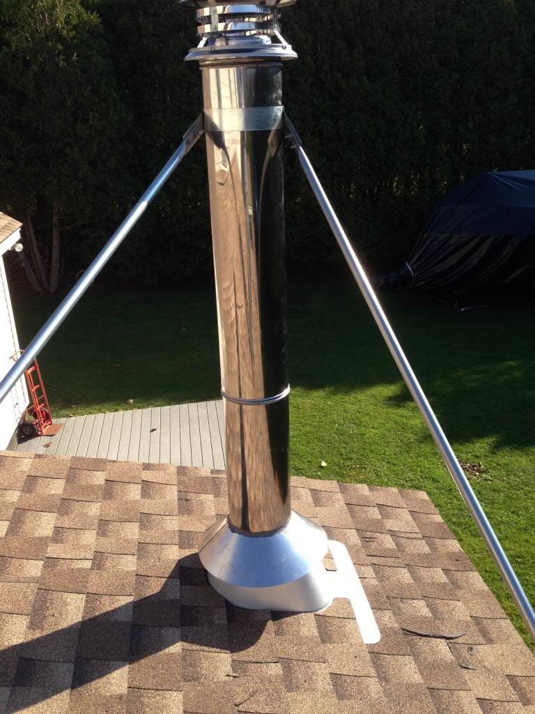

    So, with Norm Abram up on the roof working his magic and dry fitting the shingles, I set to unpacking my shiny new chimney pipes, cap, and braces. This stuff is shinier than my Harley...I hate to even touch it...a 4 footer and a 3 footer ought to get me the chimney height I need. Time to get up on the roof and start slinging the roofing tar...lots and lots of tar...

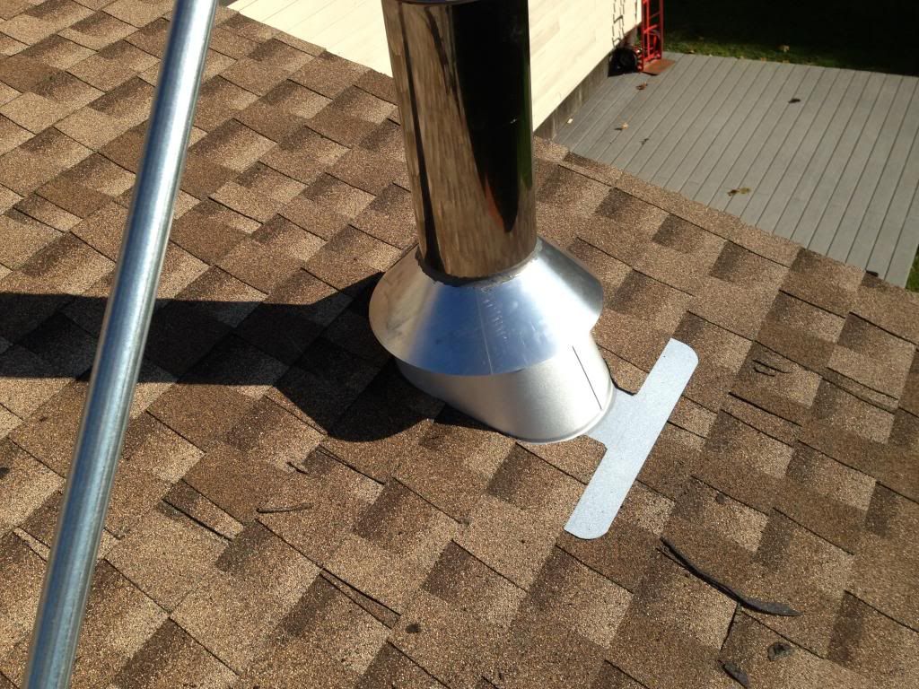

    We had a slight difference of opinion on the flashing...I was inclined to take a much simpler path that I had seen in the Duratech installation instructions and Kyle was intent on going a little more extreme...I really couldn't find much fault with his approach though...he certainly covered all of the bases...water isn't getting in there unless the entire house is submerged...lots of gooey roofing tar under there.
    I put on the storm collar, but I wasn't totally satisfied with the locking tab design so I used a couple pop rivets to keep everything nice and tight. Unfortunately, the high temp silver caulk had a real loose consistency and I made a bit of a mess with it. I'm not entirely proud of the caulking job on the storm collar. I suspect that it will be water-tight however.

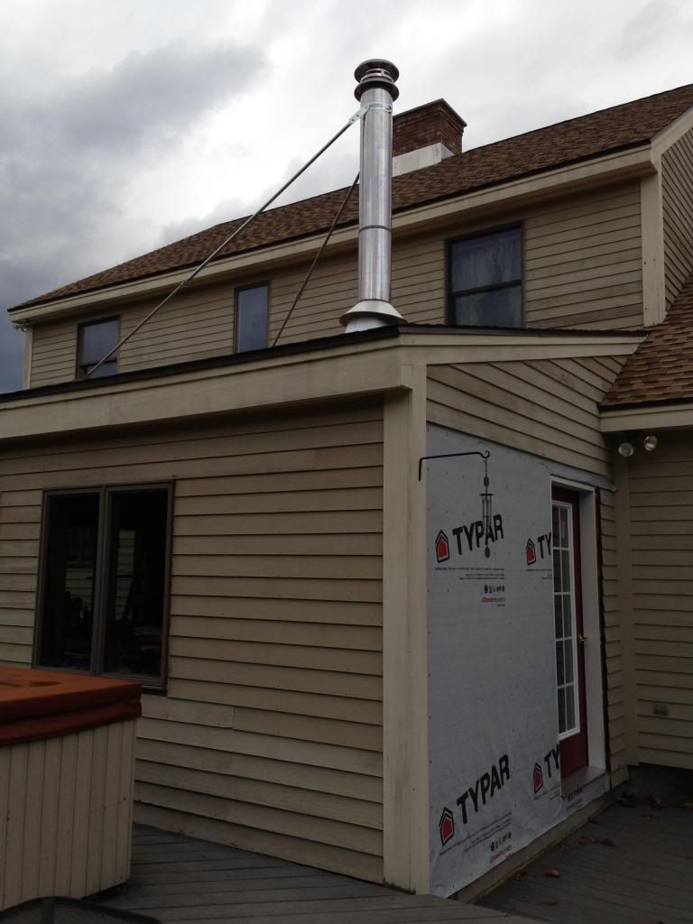

    The chimney pipe screwed together easily with 1/4 turn or so to engagement...making sure that the seam is facing the house for maximum aesthetic pleasure from below...then the cap and finally, with the help of a 2' level, the braces.
    Now all I need is that crew of Munchkins from the Wizard of Oz to give it the same buff treatment that the Tin Man got...

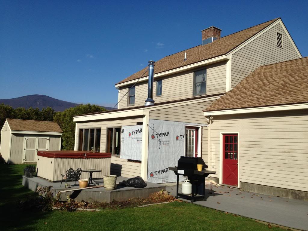

    Down on the ground, things are looking pretty good...the chimney is about 14' from the main house and the wind blows due east from that mountain in the distance. I'm definitely good with the whole 2' from the top/10' from the roof thing.

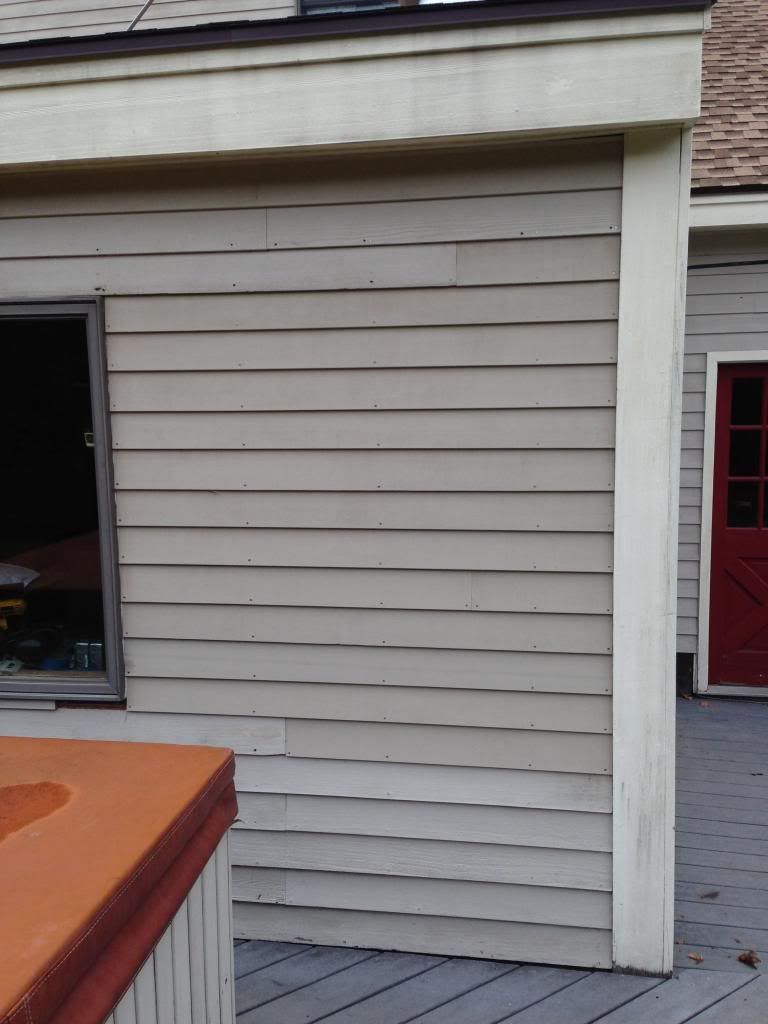

    Off to the building supply store for 600lbs of mortar mix and some cedar clap board. I really need to get this place buttoned up before the snow comes. I made a little headway before the rain came...
    [​IMG]
    [​IMG]
    The whole back side of the house could use a coat of pain next summer.

    Nice looking pipe sticking out of a great looking house.

    Looks great. Is there a reason you went with the length you did as opposed to shorter if it still met code?

    Manufacturer's recommendation...12-14' total from the bottom of the stove to the top of the chimney. I think I'll be right in the middle of the range.

    Makes sense, mine ended up being in that 13' range but only 4' sticking out above the roof.

    You know, now that I think about it...there's no way that the chimney is 11' long. I went out and looked at the boxes...turns out it was a 4' and a 3' section of chimney pipe. The chimney is 7' tall from the bottom of the support box which equates to about 6' above the roof. I think the double wall stove pipe will be about 6' in the house. I think I'll be about 13' when it's all said and done.

    Makes more sense to me now, 11' feet is a lot of chimney.
    [/quote]
    Ross don't sweat the caulking thing - as long as its watertight you got 'er beat. Nice job - you guys are on fire (no pun intended)...
