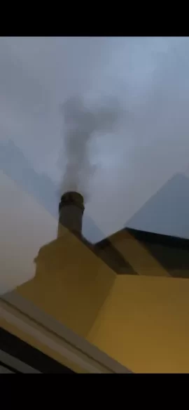

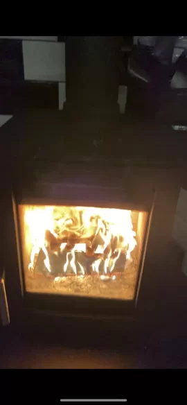

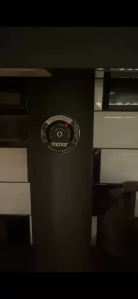

Hi all - I’ve made an account here in the hopes I’ll get some guidance on a stove I have inherited.
I’m having issues with smoke from the chimney. I am burning kiln dried wood (moisture checked to 11%) at the correct temps (as far as I can tell with thermometer) and the chimney was swept only a month or so ago. So I am stumped. Maybe this amount of smoke is normal but everywhere I read says very minimal smoke or white steam like smoke. I am getting very dark nearly black smoke which forums are telling me I am burning something incorrectly or worse something toxic - which I am definitely not).
The smoke does seem to clear somewhat once the fire has burned down a bit so maybe I am just paranoid but it does seem a lot more than I would expect. I live in a smoke controlled area but I am more concerned about what’s happening inside my chimney with the colour of smoke - if something awry is going on and I am at risk of chimney fire.
One other relevant thing to post is that the chimney was extended very recently and the exisitng flue had an extension piece of flue connected to original flue length, fire cemented together, then the stone masonry was built up. I don’t know if the existing masonry which is very old is maybe dirty and heating up old soot to cause smoke? Or the guys who done the chimney extension have cocked it up somehow?? Mind I don’t know how you’d cock that up. Chimney sweep seems to think it’s grand and to burn away but it keeps bothering me.
Posted some pics of fire box, temp reading and a couple of the smoke being produced in real time.
Help appreciated - even if it’s just telling me this is normal!

Many stoves sold in the UK lack secondary reburn technology to clean up smoke. What is the stove make and model?

Hi - it’s an aspect eco 4 I believe - which does have secondary and tertiary burn according to manual and allowed to be fitted in smoke control area.

Once the fire is burning strongly is the air control being lowered to a very low amount, like only 5-10% open, or enough to make the flames lazy, but not out?

I am lowering the air control once I am getting white ash and the fire is up to temp but not fully closing. If I put it down to lazy flames I get more smoke if anything. I think it’s hard to tell - I did think maybe it’s too much draw and the secondary combustion isn’t having a chance to burn off the gases - not sure.

Thanks for the reply. This the first load I put in - maybe this is just how much it smokes when lighting up and refuelling - does seem a lot.
The tertiary holes are not covered in pics and the fuel amount is below the weight limit for firebox guidelines

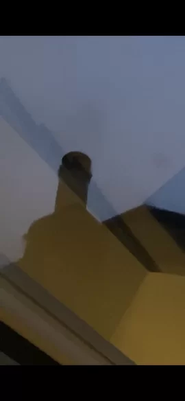

Here are some other pics from the same fuel burn but slightly later on and with air controls open for longer fire burning hotter. Less smoke definitely - sorry hard to see in pics but still some dark/black puffs of smoke but not streaming.
Maybe I’m just being mental!

you have to reduce the air that comes from below ( primary ) this will allow the secondary to burn cleaner.

How dry is the firewood? The best design is going to smoke if the wood is too damp inside.
In the manual, they confuse terminology. It looks like they are calling "secondary air" the airwash which is actually still primary air. They call primary air what we call boost air, which is directed at the bed of the fire. The tertiary air is what we know as secondary air. It is located at the back of the firebox. My impression is that this setup is not going to do a good job of burning smoke that is coming from the front of the fire and straight up past the baffle.

Hi Begreen - it’s kiln dried and I even bought a moisture meter to check and reading at 11% bought in sealed bags and left to dry out further in the house before burning so it isn’t the wood. Do you agree this isn’t a normal amount of smoke - even when starting a fire from cold?
Yes, I wouldn't be happy if a stove smoked like that after it was up to temperature.
