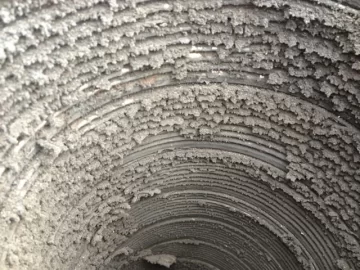

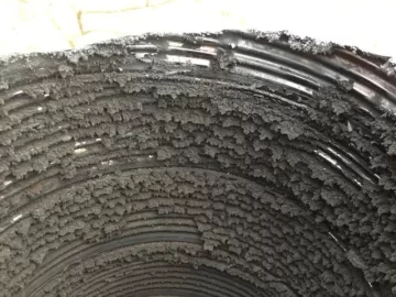

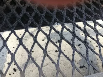

Checked my chimney today and here is what I found. I installed my liner in Dec. of '11 and it hasn't been cleaned yet. I checked at the beginning of the season and it looked good. So this is over a years worth of buildup. This is at the very top and gets progressively less the further down it goes. The shiney [Hearth.com] Help with creosote evaluation on new liner.[Hearth.com] Help with creosote evaluation on new liner.[Hearth.com] Help with creosote evaluation on new liner. part at the top is where I tapped the outside and it fell off so it isn't sticking very much. My only experience with chimney cleaning was this chimney with my old dragon and a slammer install. Lots of the shiney creosote with that one. I don't have any brushes yet but need to get some soon. I think this is pretty good for over a year of 24/7 burning but wanted wanted some more experienced eyes to evaluate it.
Ain't no thang. Looks good.

Where's the beef?! Looking good there. You can relax the OCD. ;)
Keep on doin' whatever it is you been doin'. Rick
Top is always the worst looking. That is where it is the coolest. Wouldn't hurt a thing to run a brush down that, but wouldn't hurt a thing to wait 'till the end of the season either. I wish I had a picture(s) of some of the flue blockages I saw in Europe while I was stationed over there. I think there are about 4 people in the whole Army that know how to run a stove. But every GP medium comes with one..

Top is always the worst looking. That is where it is the coolest...
A few have also reported their worst build-up where the stovepipe meets the liner, presumably due to fresh air entering (and locally cooling) at that junction.

Looks good.
Thanks for the feedback and confirmation. I'm running this without insulation but jammed about 2' of Roxul up from the bottom and about 3' down from the top. Because of what I have learned here I'm burning only truly seasoned wood and burning hot complete cycles.

Your putting many others to shame. Well done.

Lookin' good! :cool: I would get a poly brush, then hit it at the end of the season.

Sure looks like your burn habits are based well! And you can sleep easy when the stove is raging hot and you're slipping into bed, priceless.
Better than me... I would finish off the season then clean.

Your flue looks pretty darned good to me, that is almost textbook as to how it should look after a season of burning.
