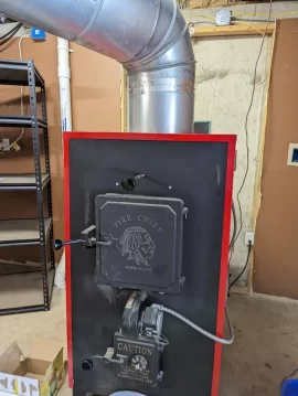

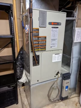

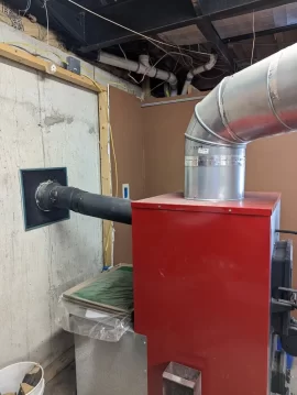

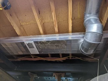

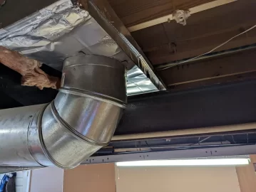

Thank you for getting back so quickly! This is what I am working with. And yes, it is the FC500.
As far as the wood, it is dry. I do know that I recently had some wood that wasn't, but that was before this cold snap. There was a dusting of snow on the more recent wood I brought in, but I make sure it has been inside for several hours before putting it in the furnace. I will try make sure and be careful with the wood I use. I have read that is something that really effects the heat.
Now, this could be me being an idiot because I don't know anything about heating equipment, but I don't think there is a back up heater or anything? Again, I could be wrong. And thank you so much for the help.

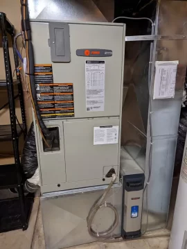

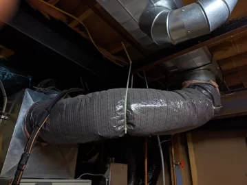

That Trane unit is your backup heat...electric I'd say...spendy to run, I'm sure that's why they put the wood furnace in!

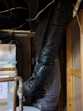

So can you label those pics as far as what's going to where?

Is the blower in the metal box (with the air filters sitting on it) running when the FC500 gets hot? It should be...that's what pushes heat to the house.
Can you get us a pic of the right side of the FC500...looks like there is a fan control/limit switch over there on that side? That what turns the blower in the back on...if it has a white button on it (the switch) push it and see if the blower comes on...that is the "manual" position...pulled out is "auto" and should kick the blower on/off when there is heat there to push out to the house (or shut if off if not)

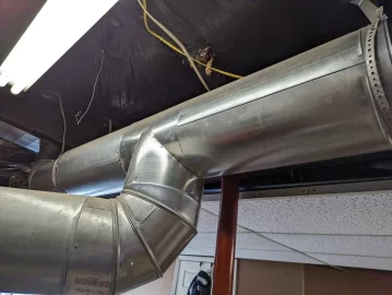

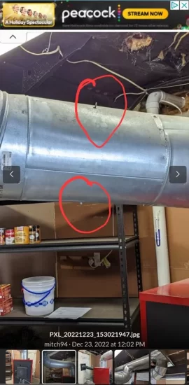

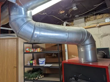

I see a damper rod in that section of duct above the wood furnace. Right after the first 90. Is that something the previous owner might have closed when running the trade?

Yes definitely could be wood issues. Dry on the outside does not mean dry on the inside too. Also think there is something else going on too. Like a damper issue as noted by Highbeam. But he must have better eyes than me, I'm not picking that rod out in the pics.
That's just a HX bypass for loading...which does need to be closed (pushed in I'd say) after loading or that would cause low heat output too.
Was wondering how you came to that conclusion, and then I saw the large gray cable in one of the OP’s pics. The 65k BTU ( 19kW ) toaster bank on my geo system costs roughly $3 an hour to run.
Do you think the OP should run the furnace fan also ? That’s how my HVAC guy set mine up initially, I chit canned that idea after a week or so.
Look like return air is being pulled from the floor. We all know how well that does too.
Not on the furnace, on that large duct above the furnace between the first two 90s on that straight section of ductwork. See the axle rod of the damper? Couldn’t that be closed?

Yes, that definitely needs to be open for wood. Can't see its position in the pic. Or my eyes can't, anyway.
