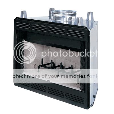

I did not read the entire thread but if I am correct you are looking to have a wood burning insert installed , We have done a few for customers over the years...They are for the most part Zero Clearance, you create the proper RO and basically slide it in.....The interior should have a fake Brick package, have the install done by a proffessional, the ducting will cost almost as much as the unit...The process for us breaks down into a few parts,,,part one framing, this includes the opening, and any and all provisions for the ducting, cutting through roof, chases, etc...Next the FP installer will do his thing, mostly about hooking up the pipe....Lastly and most important for the full effect is the front face, elevation, stone, mantle, etc.....This part will really make or break the job, our goals are always to create a FP that looks traditional. If done well, at a quick glance the average person will think they are looking at a real masonary FP...Technically they will put out heat, but not as much as traditional FP because you do not have a good thermal mass....traditional F places are not good in general, but the insert is a step down for sure....Fans that are available as options will definately improve the heat output significantly....remotes that are wireless are nice to adjust the fan speed....some of the larger units can really deliver the BTUs with the fan option...Lastly, if you are worried about power outages and heating specifically, you can just accept the natural radiant heat that the FP will put out without the fan, or you can back up the power to the fan with a deep cycle battery and a "STOVE DEFENDER" type setup, this will at least allow you to run the fan for a few days on and off until the power goes back on....Generators, Solar panels, all options, but the simple Stove Defender might be enough to ease your mind....
Ok the terminology is wrong here inserts are not zero clearance units inserts are meant to go int a working firebox that is built to code and you could have a fire in. Some inserts can go into some zero clearance units as well and any insert needs a liner hooked to it. A zero clearance unit is what you are referring to and there is a wide rage of them available from basic builders boxes that are very inefficient to ones that are zero clearance woodstoves and are very good heaters and allot in between.
Yes that is a zero clearance fireplace not an insert they are very different things and are not interchangeable at all. I have seen an insert installed as if it was a zc unit and i have no idea how they did not burn their house down. Most people including you i am sure can tell the difference but confusing the issue by mixing up the names doesn't help any.
