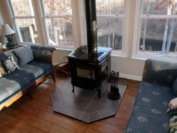

Here are some pictures of the new stove! The installer still has to finish up with the flue pipe. I think it really looks nice. BTW, it is the Alderlea T5 in the black porcelain enamel.

Woohoo, it looks super! The black enamel is very classy.
18" is ok for a shallow firebox, but I like a longer handle on my tools for this deep firebox. Can you exchange for 24"?
looks great and i like that u took out the carpet this will make it easier to keep floor clean. you'd be surprised ho many people would see this as a asset in a home with these tough economic times. i would never take this out if u were going to sell. good job.....

Looks great! Love the view out the back windows. Is that a fishing pond out there?
Yes, there are fish in my pond. There are large mouth bass, bluegill, and probably a few catfish. The view out the back is what really sold me on this place. Sometimes I have wood ducks swimming on the pond and there are also a lot of deer.
What a classy looking install! LOVE the T5.
I don't think I'd move from that space all winter long.

I know this is a convection style heater, but would like to know if you'll find the seating a tad too close.
I should have it up and running by this Saturday! I'll post some pics of its first burn. From what I've read about this stove, it has a 'gentle' heat off the sides, but if I need to I can move the seating further back. I plan on spending a lot of time with this stove this winter when I'm not hunting. I'm glad I got the enameled version, it looks really nice and will complement the space even in the summer. Thanks.
The seating looks fine. This stove does not get too hot on the sides.

Wow, congratulations--stove, install, floor, view--they all look great!
And thanks for sharing your experience, including photos. It's fun and helpful to see the process, from start to finish, including middle part where you said "It would be easier to buy a house with a stove." Great to see it turn out so well. Good job.

Yeah, I finally just got tired of debating on where to put the stove and I finally just decided to put it in this room and leave my gas logs in the great room. I think it will be good to have both. It will be more flexible, especially when I'm not home and my wife doesn't want to build a fire. Now that I see the finished product I know that I made the right decision and I think it adds value to my house. The Alderlea T5 is really a great looking stove.
