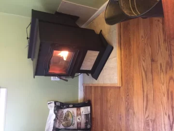

Meh.
Note: stove is pulled out from wall for cleaning.

I'm not a fan of that color but was envisioning something like soapstone, which I think would look awesome (probably an awesome price too. Or, tile the color of your walls (or maybe a couple of shades darker?). However, I think you are onto something and how it looks in a room can be completely different from what it looks like in a close-up shot.
I'm going to go to home depot and check out some things. I only have a little dab of silicone holding it in, so I can experiment
