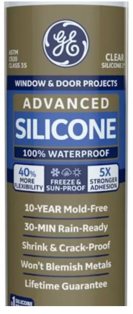

No need for high temp in that location. I think that Meeco's is more of a sealant than adhesive. Regular silicone is ok. Choose one with good adhesive qualities and meant for outdoor use. GE Silicone II window/door is good stuff. Wipe down with alcohol first if there is any oil on the pipe or flashing.

Same for stove painting too. FWIW, I have been impressed by the bonding strength of GE Silicone II.

Oh and I recommend clear silicone for the Stainless chimney. I thought grey would look better but it doesn't.
Yes, clear, with good UV resistance and strong adhesion. I looked at our flashing after 15 yrs and it looked good.
