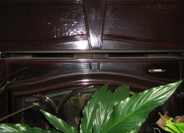

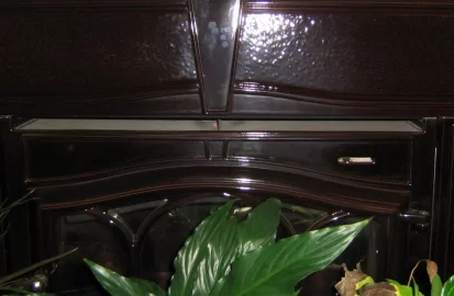

Here are some shots of where I'm getting my temps from on the Jotul. I'm definitely sure I got 450-500 there on these aim-points. So I'm still a couple hundred degrees away from concern and 100 away from doing normal work? I did indeed like the hot dust thing. Breaking in the Jotul I was able to smell every new temp threshold.
[Hearth.com] Honest question - how would you stop runaway Jotul?[Hearth.com] Honest question - how would you stop runaway Jotul?
Maybe someone else knows what the temp differential between front and top is for the Jotul. May be quite a bit different than for my PE Super. The opening is quite a bit larger for me so I can laser in and measure the top as well as the flue collar. That is how I found out about the difference between temp on the top versus front. I now use the front temp almost exclusively because it is much easier to measure.
