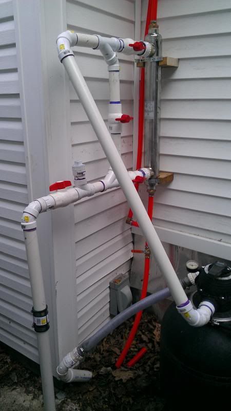

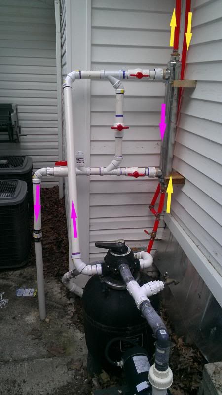

I got the pool heater hooked up and ready. Not to many surprises. 1 inch pex, HE from OFS.

I have the same style heater hooked up to my system. It works well, especially with my 1000 gallons of storage as a buffer.
I have an aqua stat that controls mine along with a switch.
The one thing you have to be very careful of is;
Absolutely make sure if heater lines are running your pump stays running. It will melt the pvc fittings enough to cause leaks.
You can install a flow switch so if the pool water is not flowing the boiler water stops.
Watch those pvc fittings, they are dwv. Usually Pressure fittings are used for pools.
