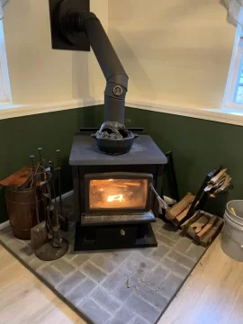

Here’s a pic of the unit and the inside for visual reference.
[Hearth.com] How big of a firebox should I upgrade to? [Hearth.com] How big of a firebox should I upgrade to?
Several older stoves from Lopi and Osburn used to use firebrick for the baffle. They were certainly tougher than today's baffle boards, but the modern versions burn cleaner.
I can’t wait to see the difference between this stove and a stove 33 years newer. Probably going to be a night and day difference. Although I will miss the sheer ruggedness of this old one
