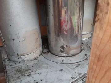

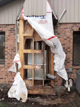

I am demoing to remove some rotted framing around and below my zero clearance fp. (https://www.hearth.com/talk/threads/iding-type-of-fireplace-and-potential-insulation-issues.182769/).
I need some help determining how to detach the unit so I can pull it out, as allowing me access to replace the rotting plywood and framing below. I can't for the life of me figure out how to detach it. The manual (https://www.google.com/url?sa=t&sou...FjAAegQIAhAB&usg=AOvVaw0oMYq0WcFpdLnGWcfqtugs) states that there are four mailing flanges to secure it to the floor. I don't see any. I can remove the heat ducts with a counterclockwise turn, but not the chimney pipe itself. Any ideas? Thanks!

Thanks. I did, but it doesn't detail how the chimney connects to the unit (and hence how to disconnect). I am probably overthinking it, and just need to be a bit more forceful with turning the pipe. I suppose it isn't attached to the framing/flooring any other way.
Typically the unit is screwed to the framing studs. The pipe is attached to an anchor plate that’s brand specific. Often times the pipe is screwed to the anchor plate to prevent it from turning as the rest of the pipe is installed.
