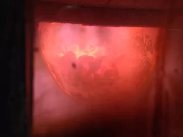

Something I would really like to try or find is a nozzle liner made of stainless, that just fits inside the nozzle, with a lip on the top so it wouldn't fall through (think small pot with bottom cut off), and with some grate-age across the top.

How's it holding up? Maybe weld a couple or 3 stainless rods across the top to help hold the coals up there?

Maple, I have not taken it out but it seams to be holding up. Havent paid it much mind actually. I will look it over in six weeks if the groundhog was right today. It burns very nice. But i did have an issue a few weeks ago where a chunk of wood completely blocked the nozzle. Kinda made a mess!
