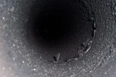

Swept my chimney this weekend and found the stove pipe had a thin buildup of creosote. pic 1 is a pictue of the inside of the stove pipe before cleaning. How does this look for 2.5 months?

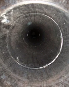

Pic 6 is after cleaning. A thin layer of hard creosote was left behind close to the connections of the pipe. The brush would not take this buildup off. Figure I will spray a remover at the end of the season. But then again isn't the pipe going to have little buildup.

looks good after cleaning and should work just fine for you
