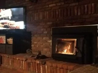

I cannot believe the difference!!! It was in the 50s today 60 inside. Fired up the stove to smoke things in with the new pipe and sealer. After getting all the smoke out of the house, the stove heated the upstairs to over 70 in about 15 minutes. And has stayed there all afternoon and evening. It is now below 40 out and I haven't dipped below 70 inside. Wow, what a difference!!! I think it might be too hot in here!!!! Basement is another story and will try to start moving heat down there but I am good where I sit. See picture!!
Congratulations dude. You are on the way to warm winters now.
