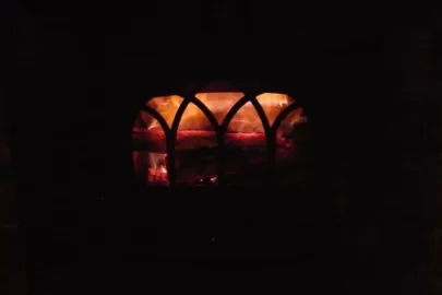

Snow coming. We are cruising nicely at 650 right about now.

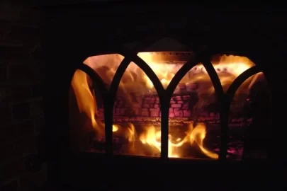

Yeah Jotul says to put the magnetic thermo in one of the corners on the top plate. I run top right - same thing. Just reloaded here, lovin this stove. I basically load the firebox pretty good, burn it to 600-700 range, then back off the air and let it cruise at 600. I def like the amount of air the EUR plate lets into the firebox vs. the USA plate. You can really get the stove crankin when you are at full open. I think the USA plate is too restrictive.
