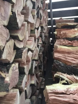

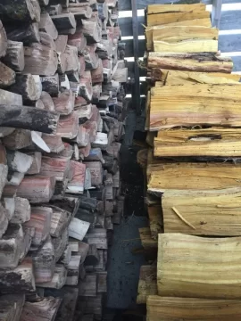

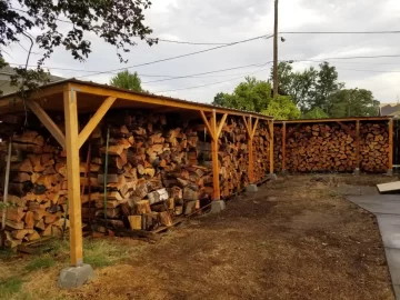

First year using this old crib. 2”x6” uprights are about 20” apart so I just stack between them. Piles 10’ W x 8’H x 16-18” lengths, figured that should give ample air flow. I guess I will know next year.

This is the south facing wall so I piled up a bunch of ends & pieces 4’ high against the wall tapering out to a few against the panel, then put my small rounds, branches on top. Line of thinking was south wall would get more heat & wind so they should dry ok plus they are out of the way & gives the Mrs. access to wood so she quits tossing good splits into her burn ring. !!!

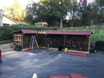

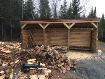

I was splitting my wood at the same time that I was building the shed, but give or take a couple of weeks, all of my wood got split and stacked right into the shed without spending any time baking in the sun. My yard only gave me the one option of where to build my shed, so it faces east (which doesn't get much sunlight - just a bit in the morning), so it's the wind and summer heat that's drying my wood. I am 5 rows deep in the shed, with about 3-4 inches between rows. I put green jack pine in there (which does dry fast) and it spent one full summer in there, and now i'm burning it. Moisture content on the face of fresh splits between 12-16%. I think letting it breathe and keeping air flowing through your pile is the most important thing. Good luck!

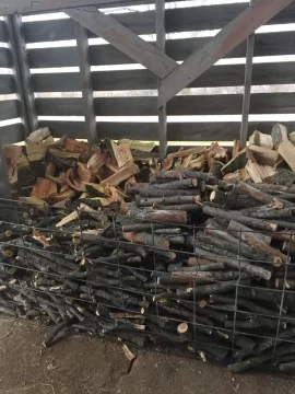

I can get the panels cut to any length and you're right the bigger the overhang the better. I was thinking 8' tall so when I put the pallets and have the header for the roof I will have ample headroom doe I'm not bending over all the time and not whacking my head like my current ones. The metal fence is a great idea chicken wire work you think?
What are the dimensions of your shed?

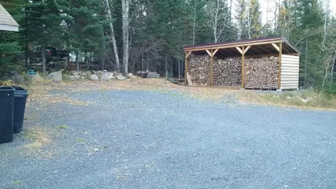

Each section is 8' deep 7' tall in front, 6' in rear and 8' wide. Five sections in all

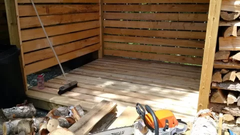

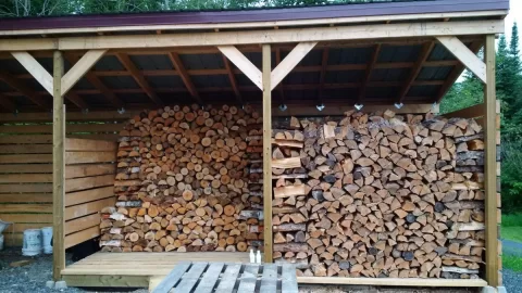

8’x24’, and i used 8’ 4x4 posts on the back and 12’4x4s on the front to slope the roof. Then i built little pony walls to separate the space into 3 stalls - they are removeable. Rough cut 2x6 for the siding and flooring. Just have one stall left to put floor down in - gotta burn the wood up first! Building this shed was my first real attempt at carpentry - pretty pleased with how it turned out. LOTS of time and a bit of cussin’ went into her creation, that’s for sure!

I don't think chicken wire will work if it is the lightweight stuff I'm thinking of. I use 2" x 4" x 6' tall welded wire fencing. I think you could also use regular galvanized chain link fencing. A roll of the welded wire fencing 50' long is about $50 for me. The slope you use and the amount of support you use on the roof depends on the load. We could get a lot of snow here, so mine is supported pretty good and has a slope of 1.5' / 12' so things can run off. Mine kind of looks like the one BKVP posted, except that I stack on pallets. 4 pallets and a 4' x 4' in the center on the ground between them covers the ground area. I have some landscape cloth with sand on top under the pallets. I'll be dead before I have any issues with my shed unless a tornado hits it, but I'll have bigger things to worry about then.
Nice! I basically have the same situation and same woodshed (mine is 16x16 and the sides are actually closed with some cheap pine board which I imagine lets some airflow). Closed sides are for aesthetics for my wife and neighbors - life is always a balance of compromises. I stack the same as you have pictured. The idea behind the shed was to hold 2 years worth of wood, we will see now that I am heating DHW as well. That being said this year I am burning 1 year seasoned wood from the shed (I am now 3+ years ahead) and I can say it burns beautifully (all types of hardwood,mainly oak and locust). I haven't bothered to slit a piece to check the moisture content because it burns well so didn't see the need. I recall reading a study over the summer that showed wood stored indoors for 1 year with no ventilation dried equally well to wood stored in a more traditional "seasoning fashion". I wasn't able to find the study or else I would have linked it here. It may have been in a thread on Hearth somewhere but I imagine folks out here read it so if someone has the link it might be interesting to post it for others.
