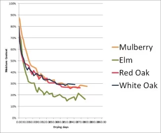

Here's a graph or some ongoing tests I started earlier this year. So far, this represents about 7-9 months of drying time, uncovered in a sunny location in Pittsburgh. It's not a great dataset, since I've only been measuring one split from each species and they're not even all the same size or cut at the same time, but it might give you a general idea. MC plummets in the first couple of months after cutting green wood, but the trend doesn't last...
[Hearth.com] How much can/does wood season in a month or two?
Jon1270 you just confirmed what I found on a wesite that I can not find right now, big % of the moisture is lost in the first 60 days or so and then slows to a crawl. So a low % wood like Ash could be 25 % or so (guessing) in a few months with good drying conditions.
My MM only goes to 42% so those figures you have are interesting.
Good job with the chart by the way.
So before anybody starts talking about varibles let me make a few points, both from jon's chart and from what I have found on the net.
This is green wood so %'s will change with diferent stages of wood, dead standing or laying on the ground.
All the other varibles we talk about so often all apply to this.
Thanks.
Yeah, electronic meters are very inaccurate for anything above 28-30%. This was done by weight, based on small samples which I oven-dried within hours of the time that each tree came down.
