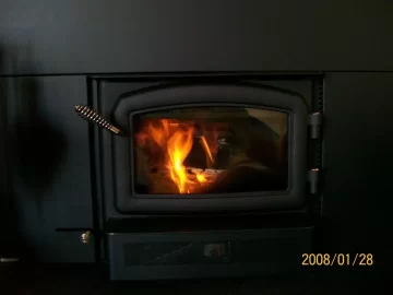

in a wood burning stove? ie, am i shooting for lively dancing flames or slow 'simmering' flames - or do I not want any flames - just the red hot embers?
Thx again,
bob

Actually, over the burn cycle you are looking for all three. In that order.
Ditto that. What I think you need to be careful about is going to fast from one type to the next, especially the last step. If you get to quickly to no flame, where you don't yet have red hot embers, you're going to wind up with smoldering wood that will kill your temps, kill your heat, and (I assume) lead to creosote formation.
While there is a time for all three, I generally want to move from the fast big yellow flames to the slower flames ASAP and spend as long in the slow flame timeframe as possible. Slow flames being very visible secondary combustion. Once the slow flames go away and only coals are left then time to reload is determined by heat needs where if the house is already fully warmed then I'll let the coals dwindle quite far, if room is still cold and stove top temp is dropping below "high" then I will minimize my coal time and reload as soon as there is room in the box.
The slow flame stage should be maximized in all cases.
I think what to remember is that lots of fast, yellow flames will make a fast but hot fire. The wood will burn down really quick at that rate.
On the other side, if you have only coals, your gonna have a slow, hot fire, but more smoldering = more creosote in the chimney.
My plan is to try and have somewhere int eh middle. Slow rolling flames. It gives off lots of heat, lasts longer, and gets the secondary flames going which means much less creosote in teh chimney!

Looks like you have a Regency similar to mine. I keep the air all the way open, with tons of flames, until the temp gets to about 400. Then I cut the air down by about 75%, and I have a lot of secondary combustion flames for 40 minutes or so then I have just some lazy flames. When there are hardly any flames, I shut off the air completely. I think this is the most efficient arrangement for me, and the glass stays pretty clean. Too bad it took me years to figure this out.
