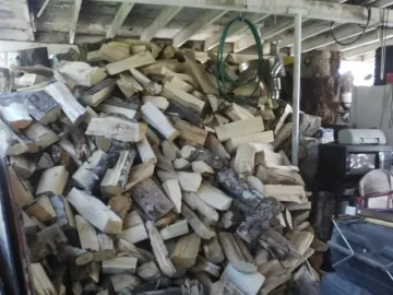

Put in simple measures, 2 rounded wheel barrel loads per 24 hours keeps my house +/- 70f unless i've been ice fishing and really need the heat, then it's three loads. 7 cord a year, average. brand new house and i gotta plastic the windows or might as well leave um open. {SuperSeal, my ass!}
2 days of wood for a 3k house.
[Hearth.com] how much wood do you need for your stove to burn all day/night long? coments wellcome :)
I just found that out for sure recently...I replaced last years wood with some I had way out back and it took 95 buckets like that to do it.

Savage,
Our climates I believe are somewhat similar, I too have 3000sf house & I believe I go through 1/2 the wood you show in that sexy bucket in the same period in mid Jan :ohh:
My readings: The stove room 700sf. is mighty toasty (talking mid Jan here) 25-26 *C (what is that in american $) %-P. Back rooms on the same level are around 23*C, the furthest room upstairs (conveniently our room :-) ) is about 15*C in the mornings & this is when the NG will sometimes kick in.
Our house is very well insulated....is yours? I just can not believe the discrepancy! We should be pretty much at par.
